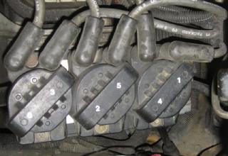

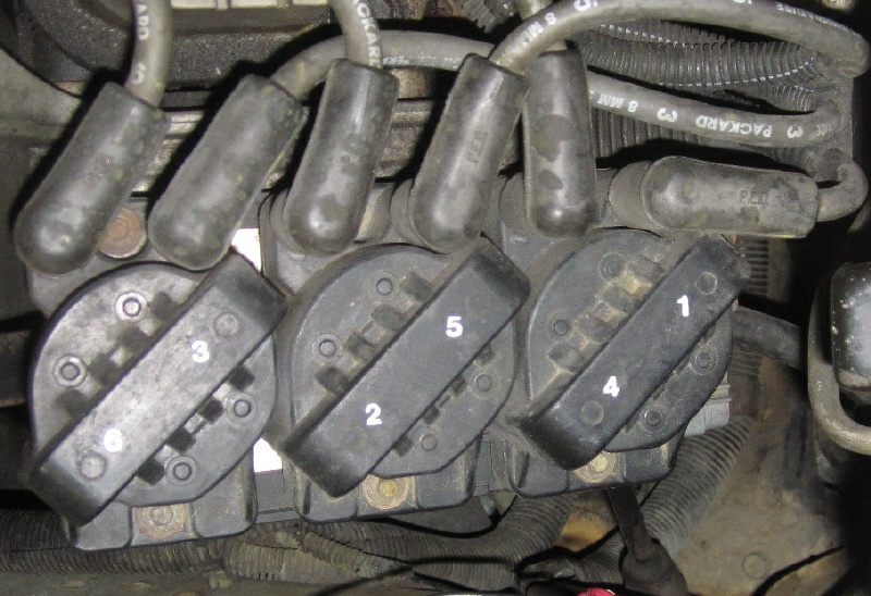

Padgett Posted July 25, 2016 Report Posted July 25, 2016 (edited) Here is a 3800 Delco coilpack connector is on right. Both plugs fire together (First saw this on a 64 Honda). Since each coil pair is just opposite sides of the same coil it is hard to fail just one (can happen if plug wire breaks or plug fouls but coil failure will usually take both out.). Odd numbers are front bank, even are rear. ps at idle you would be amazed how much the computer can compensate. Edited July 25, 2016 by Padgett Psych0matt 1 Quote

'93RegalGS3800 Posted July 30, 2016 Author Report Posted July 30, 2016 Here is a 3800 Delco coilpack connector is on right. Both plugs fire together (First saw this on a 64 Honda). Since each coil pair is just opposite sides of the same coil it is hard to fail just one (can happen if plug wire breaks or plug fouls but coil failure will usually take both out.). Odd numbers are front bank, even are rear. ps at idle you would be amazed how much the computer can compensate. plugwireorder.jpg I knew most of this, but the engine idled well on 4 cylinders rather than all 6. It actually smoothed out and stopped throwing the idler around. Does the computer compensate for the other side of the coil or some crap? I'm no good with car computers. I'd rather just carb swap and call it a day. Something is definitely plugged in wrong What though? I can swear it's wired correctly. It's the coil not firing at the #2 and #6 cylinder correctly. One has little fire and the other has none at all. Quote
