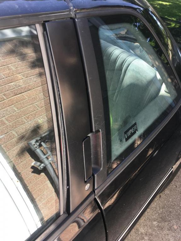

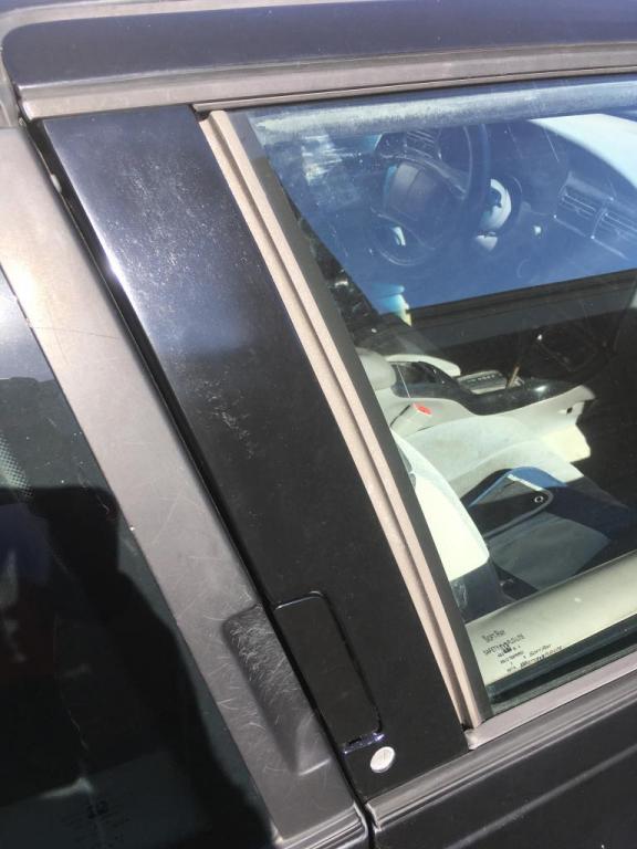

My passenger door handle broke about a month ago and I was surprised to find advance having a different brand handle. It specifically said made of plastic. Knowing my paint job's current shape, I figured one more mismatch is no big deal. The thing shipped for free and was less than 30 bucks out the door. I was confused when it arrived as it seemed to be of equal quality as the dorman ones. Not plastic. I think it was the same pot metal with the finish much glossier than the dorman one on my driver side.
Hard to speak of longevity yet. The curvature was pretty much non-existant but pulling it along the door line and mounting it made the fit adequate.

A couple photos:
Weird advance brand                                                                                                                   Dorman
