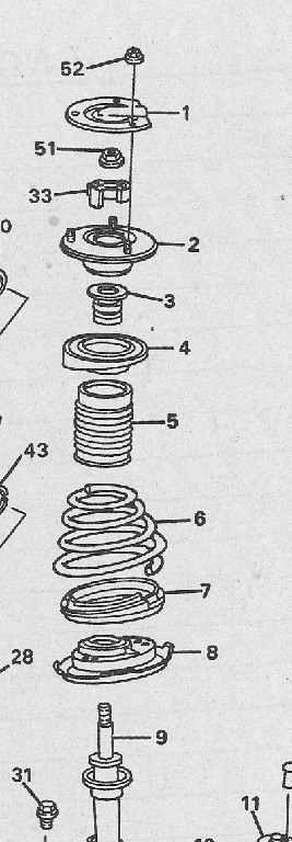

Padgett Posted June 2, 2016 Report Posted June 2, 2016 OK now I am confused It looks like (4) rubs on (2) and the three ball bearings on my E-bodies have gone away. Further what broke is (7) and (8). Correct ? Is (33) the replaceable bushing ? Quote

GnatGoSplat Posted June 10, 2016 Report Posted June 10, 2016 The bearing sits between parts #8 and #9 on Padgett's diagram. I managed to get smooth motion out of a bearing by squirting some oil into it using an oil can. I guess they're not sealed that well. It's not a bad job, but you definitely need to compress and remove the spring, so if you have any interest in replacement lowering springs, now would be the time to install them. Quote
