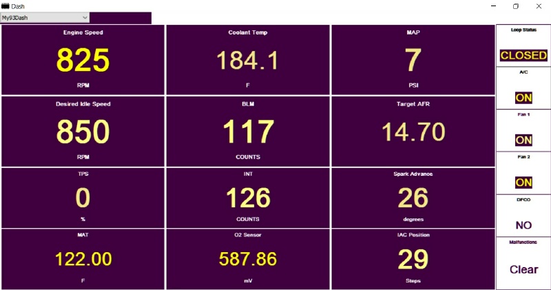

Padgett Posted May 12, 2016 Report Posted May 12, 2016 I have similar problems and a new IAC coming in. It is so erratic that it is hard to believe a vacuum leak but once it settles down it is fine. Do get the 35 (idle over 1500 for a minute in closed loop) but not the 22 . IAC command, desired idle, and TPS all look fine but idle is high but erratic for 3-5 minutes from cold start. Rapping on IAC has had no effect. What does your MAP read when idle is high ? Quote

Padgett Posted May 23, 2016 Report Posted May 23, 2016 Have you cleaned the IAC ? See "LQ1 high idle" for my latest but seems to have been a dirty contact or sommat on the MemCal. Blew a new PROM and ran for two minutes. Then 3k idle, then NADA. Cleaned everything involved and now runs fine, idle within 100 rpm of command. Starts instantly. Running 183-186F with one fan, both with AC. Happy Happy, Joy, Joy. Quote

Padgett Posted May 24, 2016 Report Posted May 24, 2016 IAC (idle air controller) ? Did you clean out the IAC passage in the throttle body with carb cleaners or a solvent ? Have seen the passage get gunked up with sticky stuff. Do you have any way to monitor things like trouble codes, IAC command, injector pulse width, and O2 transitions ? Is the idle fluctuation in open loop, closed loop, or both ? My idle is much better but still stays high (1500 rpm) when I put into neutral coming up to a stop but then idles down when stopped so pretty sure it is a command. Wonder if DFCO, I had to disable that when we put a Getrag in a Reatta. wlkstout 1 Quote

Padgett Posted May 24, 2016 Report Posted May 24, 2016 Reasonably certain: put into neutral coming to a stop and idle is around 1500 until stop, then drops to 800-900. Matches a DFCO subroutine for the 3800 I had to disable. Only problem is the TunerCat maps do not show a DFCO for $DF. Quote

Padgett Posted May 24, 2016 Report Posted May 24, 2016 Yes five speed manual code BCFA/1441. Idle IAC is in 20s but can see it increase to mid 30's/1500 rpm costing up to a stop in neutral and when speed drops to zilchish the IAC comes back into 20's and idle drops back down. Shot at nermal idle. Do have something called "Idle spark enable threshold" that is set to 2mph but suspect there is a DFCO setting somewhere but not in the TC definition. Quote

Padgett Posted May 26, 2016 Report Posted May 26, 2016 Well neutral is lower drag than drive but without being able to look at the parameters it is almost impossible, And unlike OBD-II (under $30 if you have a smart phone), a proper diagnostic system for ALDL is not cheap ), a laptop link is between $55 and $80 and Real Time software is about $40. You might be able to score an OTC-2000 or OTC-4000 for less but have to make sure it includes the GM 12 pin cable and a cartridge that covers your year. Advantage with software is that you can set it to logging many parameters, take for a drive, & later review what it was doing at each point of interest. Or you can throw parts at it until something changes. Quote
