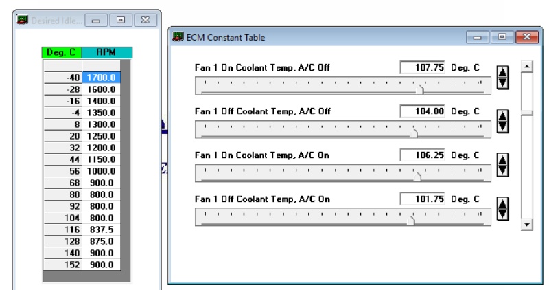

Padgett Posted April 30, 2016 Author Report Posted April 30, 2016 (edited) BTW now have the BFCA .bin and while the cold idle rpm is much lower than am experiencing (and now have the intake manifold gaskets), I definitely do not like the cooling fan parameters. Since I never change an original, I need some Memcals/Calpaks/blue carrier but suspect any 91-94 3.1 or 3.4 will have the resister network I need. Can replace the 27C256 if needed. Anyone have extras ? Would consider a whole 16149396 ECM or service replacement (I like to have a spare) as long as it has the Memcal inside. Edited April 30, 2016 by Padgett Quote

Padgett Posted May 1, 2016 Author Report Posted May 1, 2016 Found something interesting, something called "highway fuel enable" which is switched off in the stock PROM. Looks like when turned on then above a set speed (50mph) and below PE, the mixture leans out from 14.7 to 15.4. I have noticed the highway MPG to be quite poor. Also the ECM is "all in" over 80C (171F) so going to a 180F thermostat and bringing the Lo fan in at 85C (185F) and HI at 89C (192F) is reasonable. I run my Reattas that way. BTW the stock setting turns the LO fan on at 107C (224F) which IMNSHO is way too hot. I know the design max is 260F but in cars I've kept over a decade & run cool (like the Reattas), everything under the hood lasts longer. Quote
RobertISaar Posted May 1, 2016 Report Posted May 1, 2016 highway fuel is a neat trick, I've bumped the AFR into the 16.2:1 range without experiencing lean misfires, though it can probably be leaned even further. I've rewritten some code to allow for a 2D table that references MAP to determine a target AFR while in highway fuel to really fine tune AFR vs load. also be aware that highway spark MUST be active for highway fuel to be enabled. if the engine is in a condition that doesn't allow for it(table is 0'd or not in the right MAP range), highway fuel is skipped in the code. I set my fans 10 and 15*F higher than the thermostat temps, but if you play with idle speed and idle advance enough, they'll rarely need to turn on anyways. Quote
