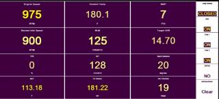

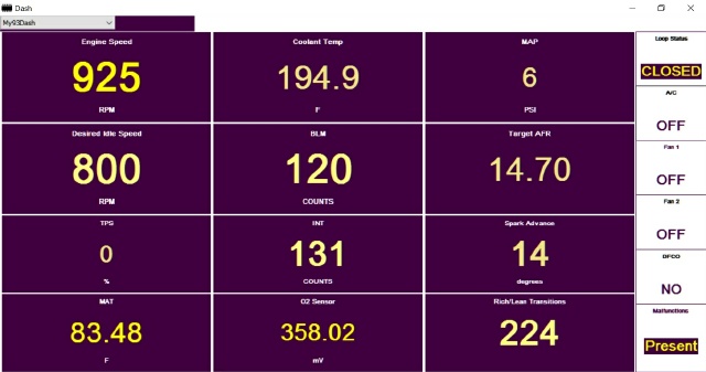

Padgett Posted May 6, 2016 Author Report Posted May 6, 2016 (edited) Now more confused than ever. Idling in garage everything is fine, start "cold" (75F). Above 2k for few seconds then drops quickly to within 200 rpm of desired. Hot idle within 50 rpm. Then go for a drive. At three blocks took screenshot below. Everything looks good and no codes but is high. Seems to drop momentarily then comes back up. Three blocks later idle is right on. Sure seems like a vacuum leak but only briefly when driving ? Ideas ? (near final display). Edited May 6, 2016 by Padgett Quote
Galaxie500XL Posted May 6, 2016 Report Posted May 6, 2016 Sticking IAC? I know you've cleaned it, but perhaps it's not closing down as far as it should. Quote

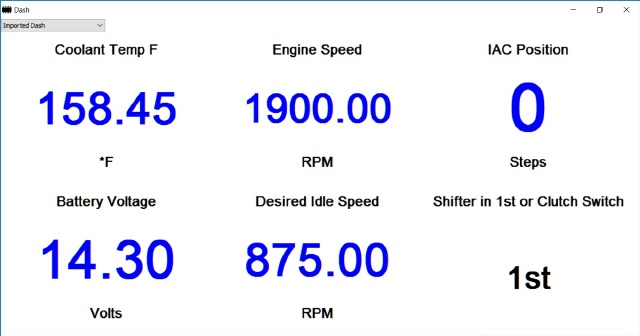

Padgett Posted May 7, 2016 Author Report Posted May 7, 2016 Tried tapping on the IAC - no change. Get warm/shut down/restart - back to normal. Wondering if a hose is off. Is there a hose that has vaccuum when cold but shuts off when warm ? Heard a "click" and idle dropped. Everything seems to work. Only code is a 35 that is triggered by an idle that is above 1500 for a while. Was also playing with TunerPro RT which is why the different displays. Haven't finalized yet. Sudden change also does not match an intake leak High Idle Close to nermal after stutdown/restart Quote
Padgett Posted May 11, 2016 Author Report Posted May 11, 2016 (edited) Oh this is crazy, start cold goes to 2500 then drops to 1250, start driving and all over the place for a mile, sometimes over 2000, other around 1500. Seems random Then suddenly the idle is fine at 875-900 and stays that way. Nothing consistent. Easiest thing to do is to replace the IAC. Seems to be available from a number of suppliers from $15 to $80 (AC Delco). Any recommendations or does it matter ? ps p/n 17112349 (OEM), 217418, 21812, AC170 Edited May 11, 2016 by Padgett Quote

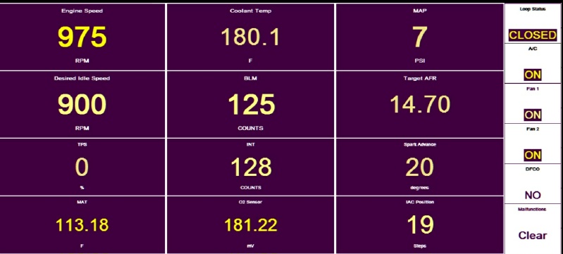

Padgett Posted May 22, 2016 Author Report Posted May 22, 2016 Well took it to Bible Study and a few errands and ran perfectly. Temp quickly stabilized at 183-186F, one fan in at 185 on/180 off) AC Off and both AC On. Have not had a chance to run up to "Highway Mode" as yet. Interesting thing was that idle was stable and smooth and within 100 rpm of command. When I had the seating issue of the PROM in the ECM yesterday I noticed a very high idle, the same as a disconnected IAC & in the 2500-3000 rpm range, wonder if a bad PROM contact was putting it in "limp home" mode. Once I verified the PROM, rang out and verified the connector, reseated everything, and started idle was very smooth both cold (1250 rpm) and warmed up (875 rpm). Set for both on above 100F when AC is on to improve cabin cooling. Quote

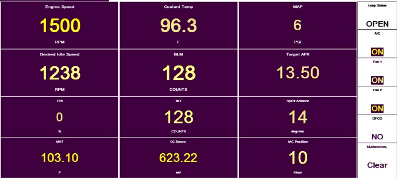

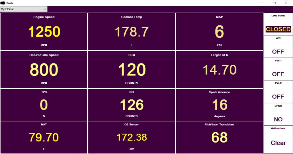

Padgett Posted May 26, 2016 Author Report Posted May 26, 2016 (edited) It is to laugh. Got everything instrumented (was just using the OTC2000 yesterday) and it ran near perfectly. Cold idle a little high but once in closed loop was staying +/- 100 rpm of command. Ran just as nice as could be. Warm out so AC on. Cold idle Coasting about 10 mph in neutral Stayed under 186F even when meandering in a parking lot. Reprogrammed for both fans to be on with AC. Never saw DFCO come on. High cold idle with low IAC and low MAP makes me wonder about a vacuum leak but must not be big. Still feels a little down on power compared to the Crossie but is a later generation 6. Edited May 26, 2016 by Padgett Quote

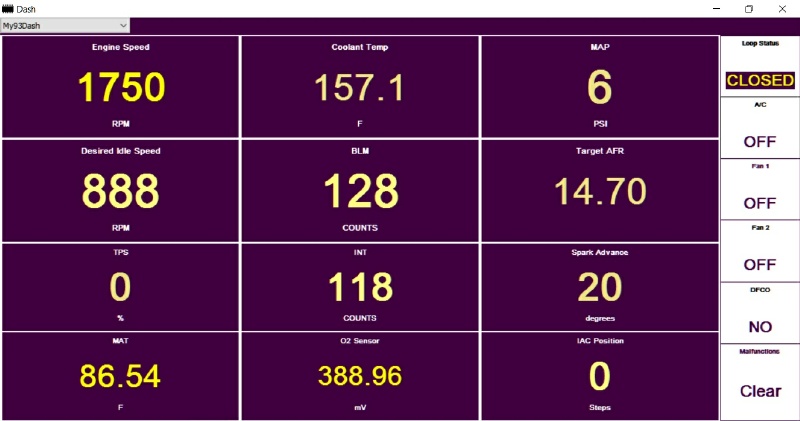

Padgett Posted May 27, 2016 Author Report Posted May 27, 2016 Good news and bad news: Bad news, the high cold idle is back. Sitting on 1750 with 888 rpm command, no IAC, and after a minute. Good news: Highway mode is working properly and engine is staying in the 180's even on a 91F day (will have lots more in the 90s as we go through the 200 days of summer. Also once warm idle is fine. Have the intake gaskets just have a 3800 that needs freeze plugs in line first since more annoying than anything. Now if I can just figure out how to get the %$#*( logging working in TunerPro RT so I don't keep having to find alt-prtscr while driving then having to pull over to save it (one at a time)... Wonder why the factory put Highway Mode into the programming then turned it off. Felt just fine on road, may lean out a bit more, usually when you can keep cool you can run leaner. Quote
