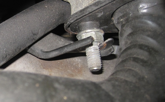

Padgett Posted April 17, 2016 Report Posted April 17, 2016 OK I get it. Mechanics don't like the LQ1 because even minor things require either major disassembly or hydraulic assist. That said I need to replace the thermostat because either is none or it is stuck wide open and MPG is in the toilet. OK I got the airbox out, have the nut on the coolant pipe holder off. Now what the %^%^&&$( do I need to remove to move the coolant pipe far enough to get the water neck off ? FSM says to remove the fuel lines and sounds like the throttle body. Really ? Don't want to cut off the flange but will if needful. Help! Quote
Psych0matt Posted April 17, 2016 Report Posted April 17, 2016 I usually don't reuse that thin bracket, never had an issue Quote
Nas Escobar Posted April 17, 2016 Report Posted April 17, 2016 There's a small rubber hose that connects that line to the throttle body. It may be worm clamped on or alligator clamped on depending if anyone has messed with it. Take it off and the line should move out the way. Easiest way to take that t stat out is by taking off the plenum. Gives you more room to play with. You don't have to mess with the fuel lines at all. Quote
Padgett Posted April 17, 2016 Author Report Posted April 17, 2016 1) that is part of the reason I live in Orlando. 2) The bracket is welded to the coolant pipe. Quote
Psych0matt Posted April 17, 2016 Report Posted April 17, 2016 Because surface rust scares you? Wimp. But yes it is, I bent it out of the way Quote
Padgett Posted April 17, 2016 Author Report Posted April 17, 2016 (edited) OK bent and removed. Did need to make a "thin head" 13 mm wrench. Does it need that brace ? Final question: the o-ring on the thermostat is the seal, there is no gasket ? ps rust does not scare me, just have a life without it. Cracking the coolant pipe now... pps Was a 195 thermostat but innards were cocked and was partly open pps been wrenching since the early 60s. Made a lot of mistakes. Am not afraid to ask of those who have been in there before. Now a 3800 or electronics or Pontiacs with carbs (like trips or dual quads) or use of a UniSyn am happy to help but this LQ1 is (a) complex and ( unknown territory. Have the FSM and parts books but sometimes "here a miracle happens". Edited April 17, 2016 by Padgett Quote
55trucker Posted April 17, 2016 Report Posted April 17, 2016 OK bent and removed. Did need to make a "thin head" 13 mm wrench. Does it need that brace ? Final question: the o-ring on the thermostat is the seal, there is no gasket ? Be careful when you start distorting tig welded tabs on old coolant tubing, if you crack that tube you've then created another problem for yourself. Yes that brace is necessary, it's supports the coolant bypass tube. No gasket. Quote
Padgett Posted April 17, 2016 Author Report Posted April 17, 2016 Bent out of way like Psych0 suggested. Cracking tube was my concern also. Think I'll leave bent, tube is not going anywhere & don't want to tempt further. Will make test run to temp before putting the air box back on. Using a 180F thermostat computer should be all in by 160F. Is a Delco thermostat so do not expect to open as fast as a Superstat (Stant does not make a 180), expect full open at 190F and should stay under 200F. Quote
Psych0matt Posted April 17, 2016 Report Posted April 17, 2016 I didn't say anything about it being the proper way, but it's worked for me on three different cars. As far as I could tell it was just kind of extra support that wasn't needed. As long as everything is bolted down tight I don't see it being a major issue. Quote
Padgett Posted April 18, 2016 Author Report Posted April 18, 2016 Well bracket is now tight against the exhaust shield. Filled it up & bled. Ran up at idle. Hit 183 and then dropped to 179 so working properly. Let it go up to 220 and checked for leaks. Nada. Looking good. No sweet smells. Leaving to soak for a while with clean drip pan under. When cooled off will make final check, top up coolant if needed, then button up. BTW what size is that bleed screw. Bottom is 10mm but top: Not 7mm, not 8mm, not 1/4, not 9/32, not 5/16. Don't have 7.5 mm or 17/64. Finally used small needle-nosed vice grip. Don't like not having the proper tool. Quote
