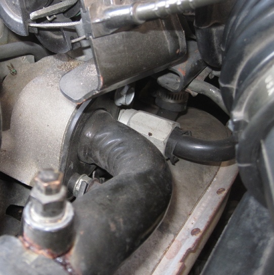

Padgett Posted April 16, 2016 Author Report Posted April 16, 2016 Look new, Delco wires. Feels strong under load it is idle or low speed where I feel an occasional burp. OTOH it does not seem to have a thermostat. Idle stays high for too long and was seeing 177F coolant on turnpike. Looks like a metal hose mount on the thermostat bolt can see ears in picture, anyone know what it is ? Seems like anything you do on this car you need to remove something else first. Quote
55trucker Posted April 17, 2016 Report Posted April 17, 2016 Partially hidden but not forgotten, that's the support for the coolant bypass tube that works it's way around the front of the engine above the exh manifold and meets up with the heater hose/outlet manifold on the far side of the cyl head. Quote
Padgett Posted April 17, 2016 Author Report Posted April 17, 2016 Now for the real question: how many things do I need to remove to get that support off the thermostat stud so I can remove the thermostat cover/water neck ? Quote
