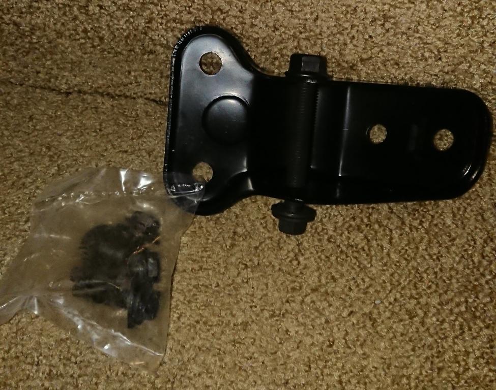

GabsOlds Posted April 30, 2018 Report Posted April 30, 2018 Are those trailing arm mounting brackets bolted onto the body? Or are they welded? I bought replacement brackets, which come with bolts. Quote
jiggity76 Posted April 30, 2018 Author Report Posted April 30, 2018 I think it was Imp who said they are dropped in from above or inside the car before they weld the floor pan closed. I believe they are welded in. Step in Imp if it was you or if I'm wrong please. Quote
GabsOlds Posted April 30, 2018 Report Posted April 30, 2018 That would make it a bigger job than a driveway gig. Quote
jiggity76 Posted April 30, 2018 Author Report Posted April 30, 2018 That would make it a bigger job than a driveway gig. I think so but I'm not a body man. I've been told by other members to avoid cars with rust in these areas unless it's a parts car. Anything can be fixed with hard work or a big wallet though. Nice work on the vert top by the way! Quote
GabsOlds Posted April 30, 2018 Report Posted April 30, 2018 Thank you. I was gonna post a diy thread on top replacement, but now the phone with all the pictures won't power up. Quote
Imp558 Posted April 30, 2018 Report Posted April 30, 2018 I ordered a second gen mount and took it to a weld shop, my welder is a small mig and I didn't trust it for that. They cut out the first gen mount and did a patchwork repair with 1/8" plate and then welded the second gen mount in place. GabsOlds 1 Quote
