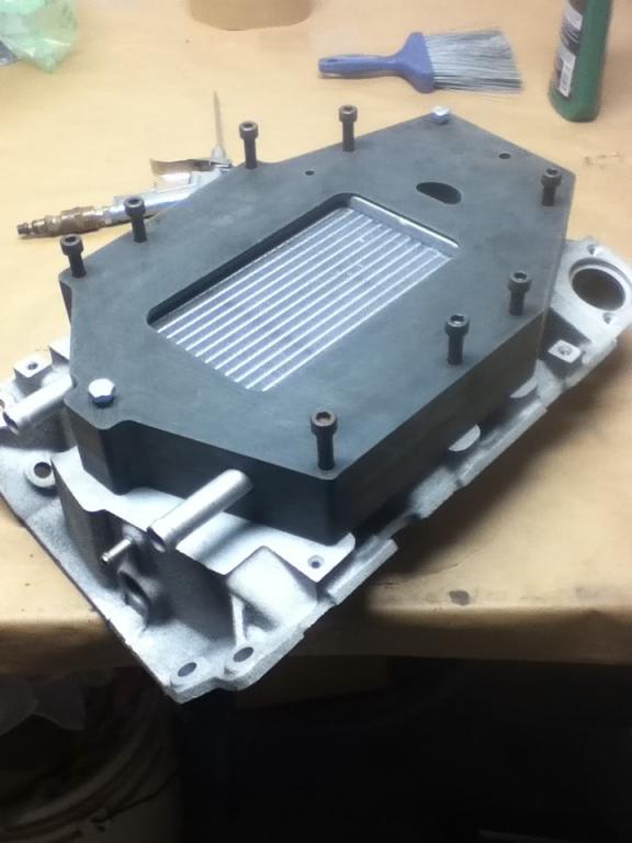

This is the guy I want to make mine, I like the idea of the phenolic body so it insulates the blower from the intake to help keep the intake cooler. Realistically if you aren't doing much boost it may be better to go with a "Short Stack" style, easier for hood clearance. Welcome to the forum.
Thanks! The "short stack" looks like a good system and it's hard to beat the price. And maybe I can persuade my wife it's a long term durability mod... :)
