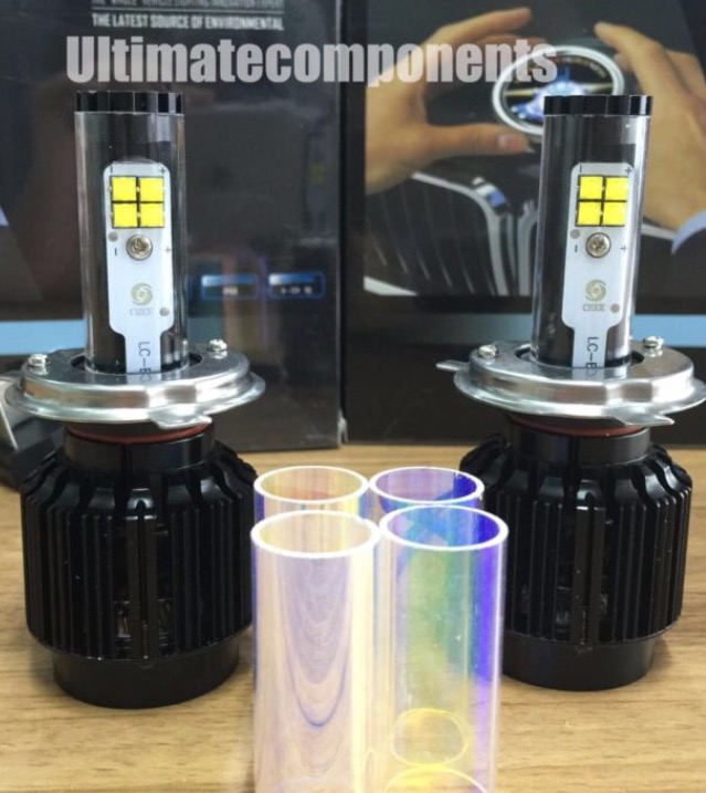

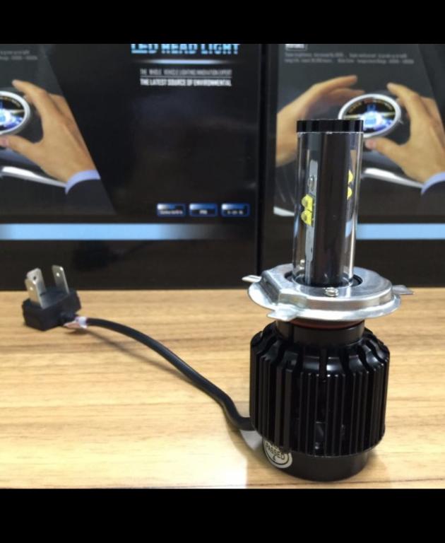

George1 Posted April 17, 2016 Report Posted April 17, 2016 I have been running these in 1 pair of projector fog lights for about 5 months. They are instant on, direct plug in and come with 3 color sleeves, 3-, 5- and 6000k for fog lights and 5-, 6- and 8000k for headlights. I had to install them without a color sleeve as it would not fit in the H3 housing. If HID's are 3000 lumens, these are about 2000 lumens as they are not as bright. Most LED's are rated for the max short term output per LED and added together for the unrealistic total output because they are not run at max output for reliability (according to Diode Dynamics). I will be adding some to the other projector fog lights and trying some of these in the Hella H4 housings in the Grand National as well to see how they work. (Photo too large, will update) I don't know how to make a link but these can be found on EBay for less than $60. Quote
Michael Savage Posted April 17, 2016 Author Report Posted April 17, 2016 That's pretty cool, the ones I posted at the start of the thread are $9 each rated at 4k Lumen and 4.3k color. I agree I don't think they're 4k Lumen by the light output you're probably close around 2k they're brighter than Silverstar Ultras by a decent amount. So vs $20-30 a bulb these are good around standard slyania price. Those are a cool alternative to HIDS color wise. Sent from my iPhone using Tapatalk Quote
George1 Posted April 17, 2016 Report Posted April 17, 2016 That's pretty cool, the ones I posted at the start of the thread are $9 each rated at 4k Lumen and 4.3k color. I agree I don't think they're 4k Lumen by the light output you're probably close around 2k they're brighter than Silverstar Ultras by a decent amount. So vs $20-30 a bulb these are good around standard slyania price. Those are a cool alternative to HIDS color wise. Sent from my iPhone using Tapatalk How is the pattern of your lights? Are they close to stock, just brighter? I thought the LED's I posted were a nice alternative to the PIA extreme white and Sylvania GXE bulbs as apposed to the $160- $200 a pair LED's that www-vleds.com sells. Quote
