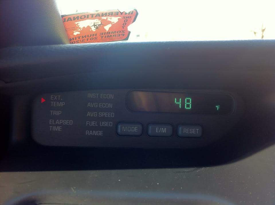

This little gizmo tells me the mpg and fuel used and my fuel gauge corresponds to it.
