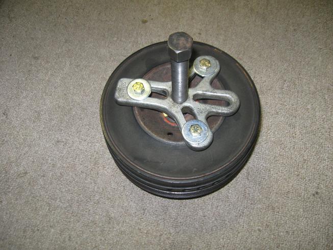

ron350 Posted March 17, 2016 Report Posted March 17, 2016 I need to remove the harmonic balancer on my 96 Regal with a 3800II motor. The problem is there is only about 2 inches between the face of the balancer and the frame. The factory service manual shows using a special balancer puller Kent-Moore J38197 with no other instructions. Has any one ever removed a balancer from a 96 3800II w-body or used a J38197. Quote

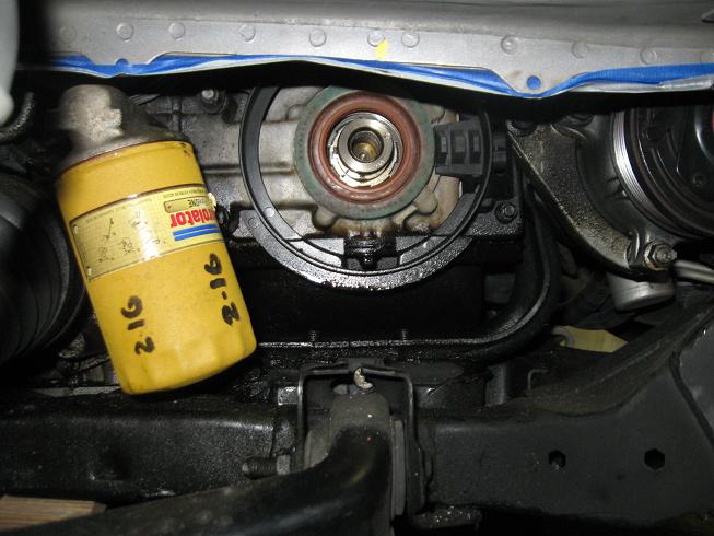

Imp558 Posted March 17, 2016 Report Posted March 17, 2016 (edited) Pull the passengers wheel and remove the flap-o-crap and you have a lot more room to work on it. The bolts are 1/4" 28P thread. Like Chris said, a 3 slot balancer puller. I think mine is an OEM from AZ Edited March 17, 2016 by Imp558 Quote
Imp558 Posted March 17, 2016 Report Posted March 17, 2016 Oh, and consider flipping for a crank sensor while it's off unless that's the reason you're doing it. Quote
mfewtrail Posted March 18, 2016 Report Posted March 18, 2016 That picture above is missing parts fwiw. That tool is much like other balancer removers, just more compact. It's missing the large center screw and the other hardware that should be included. Quote

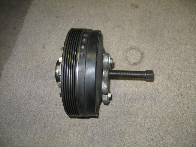

ron350 Posted March 18, 2016 Author Report Posted March 18, 2016 There was no problem using a normal balancer puller. Used three ¼ inch 28 thread bolts 2-1/2 inch long the balancer was not on that tight. Quote
