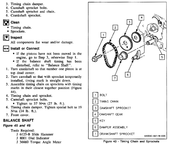

Padgett Posted March 16, 2016 Report Posted March 16, 2016 (edited) If you mean the timing chain damper (6 - long thing on right side of timing chain) there should be one bolt and it should pull right off. That is for a '91 "L" since you did not say which 3800 you have. Edited March 16, 2016 by Padgett Quote

Padgett Posted March 16, 2016 Report Posted March 16, 2016 Oh the serpentine tensioner. Am used to timing chain replacements. Psych0matt 1 Quote
