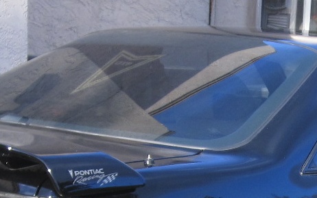

Padgett Posted March 10, 2016 Author Report Posted March 10, 2016 That is Plan B - use something I have if cannot make SWC work. Is turning into a rescue project though drivable. Have added $1500 already just in AC and tires but now are new and have a guarantee. Still have not figured out how to remove the giant decal that blocks rear vision, seems like it is under the window tinting (see pic). Have seen enough to know the audio wiring harness is butchered, question is can I restore it. Really need to clean out the other stall so can move inside. & that is a full day job. & just had to rescue a friend whose printer did not want to work (and she has an Apple - the computer for people who do not like computers...) Got oil/filter (do not care for Fram so used a PF-52) changed and is 4pm and warmish outside, nothing special just enough to remind me to clear out the stall so can work inside & out of the sun. Sunday we get daylight slaving time so can work outside later. Did run a test and looks like it does not have a thermostat, at idle it just went slowly but steadily from 140 to 200F (about 85F ambient, too 10 minutes with coolant fans off. Usually can see a dip when a thermostat opens but nada so either none or stuck open Quote
94 olds vert Posted March 10, 2016 Report Posted March 10, 2016 I like that Pontiac racing decal on the spoiler. Quote
Padgett Posted March 10, 2016 Author Report Posted March 10, 2016 Those are OK but the monster in the window is blocking my rear vision & I do not practice Italian driving. Quote
