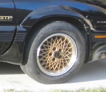

I have changed mine to 225x60x16s (stock GP) on the 8" wheels and am just feeling a touch of rub when I go over a speed bump (are lots around here). None on max braking and just for a second so a jounce issue.
Does anyone know of a slightly longer bump stop for the front suspension to prevent this or do I need to get the die grinder out ?

This is in the front. Seems to be touching the lip of the inner fender liner which is not clearanced like the flare. I don't think it has a leaf spring in the front.

225/60/16s are the incorrect size for that car.  SE models got those.  For your GTP, the correct factory size tire is 245/50/16.  These are lower profile and will take care of the rubbing issue.
Sounds like a help desk. If they fit the SE, they should fit the GTP & have two other cars with that same size (In fact suspect the 16x8 offset is the cause, may drop some 16x7s on it but I like the way the sidewalls look. Looking in the FSM, it appears the bump (jounce) stop is actually inside the top of the strut and not about to disassemble them for that.
It appears to be a lip on the inner fender well and not the GTP cladding. Think I'll trim it back to match the cladding recess. It is all invisible from the outside. Only just touches (can hear but not see any marks) when I go over a speed bump and not on cornering or hard braking.
