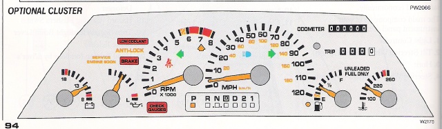

Padgett Posted February 24, 2016 Report Share Posted February 24, 2016 Had wondered when I saw that there were no markings on the '93 dial. Wonder more that it either reads "some" or none" and just those two positions which makes me thing it is a on-off switch. Question is what happens if you put a real pressure sender on the engine. Does it then give real reading or does it not work at all ? Anyone try ? Quote Link to comment Share on other sites More sharing options...
RobertISaar Posted February 24, 2016 Report Share Posted February 24, 2016 the cluster operates the same as 91/92, just that the overlay changed. if you stick an actual sensor in place of the switch/resistor combo that it probably has, then it will read "correctly". Quote Link to comment Share on other sites More sharing options...
Padgett Posted February 24, 2016 Author Report Share Posted February 24, 2016 Any suggestion which sender ? Know of at least four GM used. Fiero 2.8 GT ? Quote Link to comment Share on other sites More sharing options...
