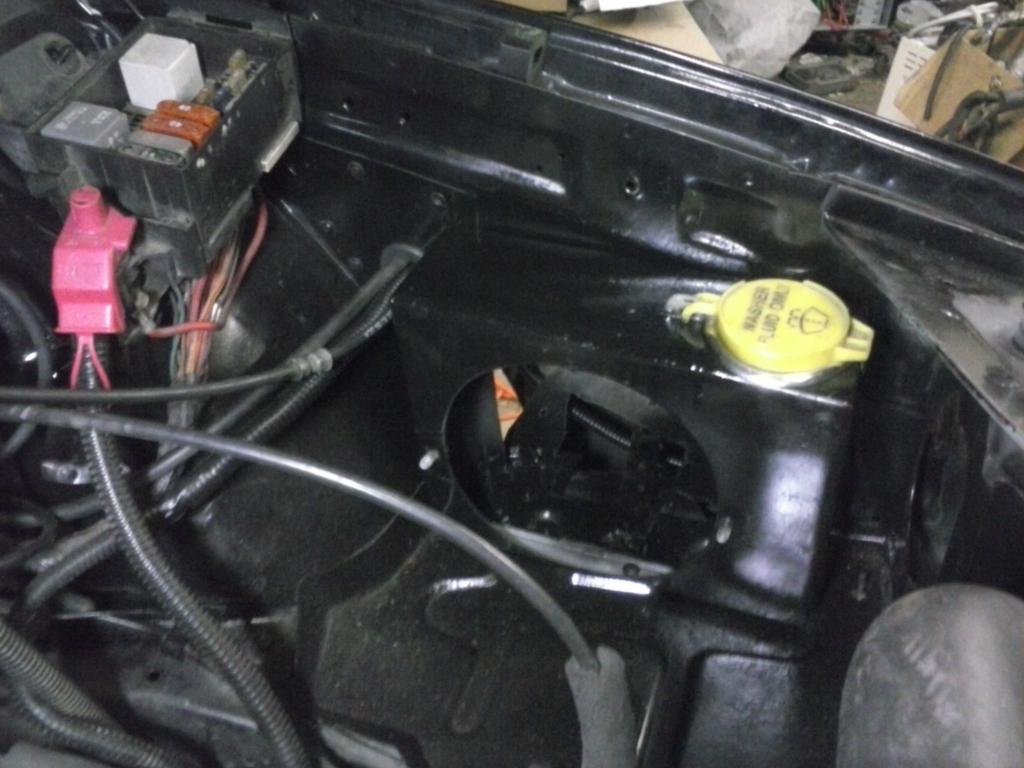

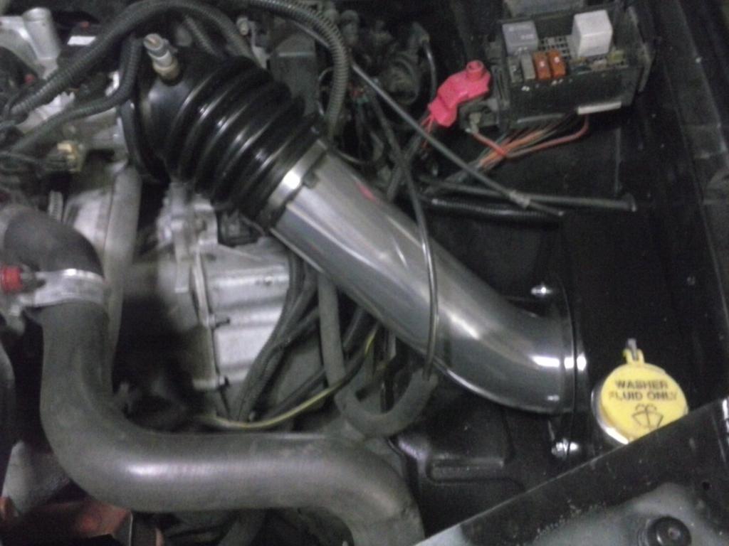

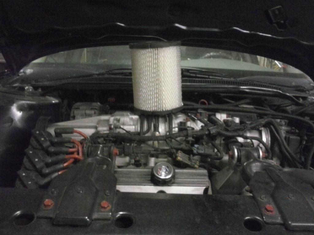

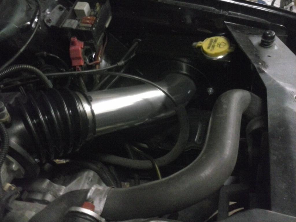

I had a really good thread on my DIY CAI but can't seem to find it. Maybe it got lost when the new site came online.
I used an OBX 45 degree pipe from Ebay, fabricated the box from sheet metal I had laying around and a filter for a 2004ish chevrolet truck.

Thanks for the information Imp558 so if i fab my own using 3" it should fairly decent? Lol love that last pic! I am going to get some parts togeather and will post before and afters, My design will completly remove the flex pipe going from throttle body to airbox.
Your CAI is looks great i would almost think it was factory, how long did it take to fab the box with the fender well and did you use foam style tape as a seal?
I didn't make a seal, it didn't seem necessary. To fab the box and lock ring was about an hour and a half. The tube is 3 1/2" and I had to put 5 - 1/4" cuts in the end and tap it in a bit to reduce the diameter to about 3 1/4" right at the end to get a filter started. Surface area is about 3X the stock filter size.
