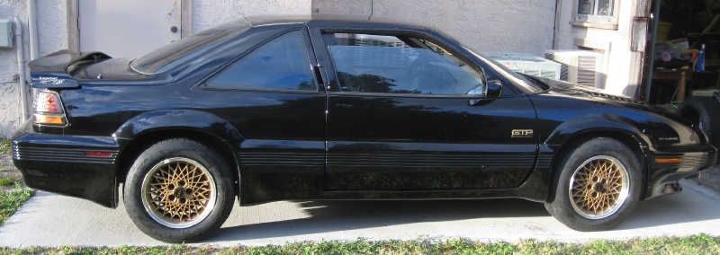

Padgett Posted February 22, 2016 Report Posted February 22, 2016 My 93 GTP had 245x50x16s stock 25.7" diameter. The stock tire for a 93 GP is 225x60x16 26.6" diameter .45" less clearance but the GTP cladding at the rear of the front tire sticks out a bit and when lifted on a slight turn it made contact on the inside.Just needs a small revision that is not visible from the outside but something to be aware of.Since we often get frog stranglers in the summer here, I look for maximum wet weather traction so the 225 makes more sense for a touring tire than the 245. Also wears longer and $100/set less expensive. And 225/60/16s is what I have on my Reattae. Quote

Padgett Posted February 22, 2016 Author Report Posted February 22, 2016 Correct & just wanted to observe that about 30 seconds with a die grinder may be needed to ensure a 225x60x16 clears GTP cladding. ps GTP got 16x8 wheels, suspect others got 16x7s. Except for the lip they look the same. Quote

jman093 Posted February 24, 2016 Report Posted February 24, 2016 They were all 16*8 Bonnevilles could get 16*7 crosslace wheels, but they were styled somewhat different And I think the offset is way different. They sit inward like an inch or something. Look funny without a wheel spacer. I've also noticed anything even slightly taller or wider does seem to rub on the body kit. The 255/50's on the rear of my black one rubbed bad when I tried rotating them to the front and my 225/60 winter tires also rub some. I'd probably just run 245/50's. Tall skinny tires look awful on these anyway. Quote
Padgett Posted February 24, 2016 Author Report Posted February 24, 2016 Mainly the center cap is silver and has a bit less lip. 15x7 vs 15x8 snowflakes are the same. 16x7 Bonne wheels on Reatta 225x60x16s 16x8 on GTP with 225x60x16s. Believe the 16x7 offset is 46mm do you know what the 16x8 offset is ? Am hearing/feeling a slight scrape over speed bumps (have a lot around here). ps apparently can use <center> </center> to force a new line since <BR> doesn't work pps: want tall/skinny ? 59 Jag has 6.00x16s. No Virginia, those are not space savers. Personally thought they looked dumb then but before wide ovals. Quote
