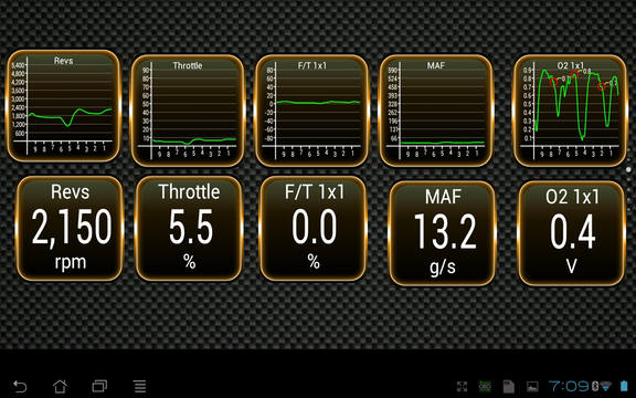

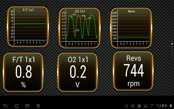

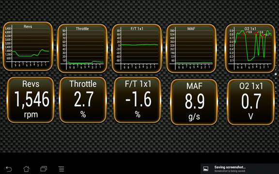

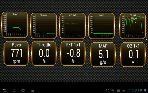

Cutlass350 Posted January 11, 2016 Report Posted January 11, 2016 If there aren't any codes, my best advice is that you'll need to data log the problem. If you have an Android device, there's a good app "Torque" that works fine with an ~$20 dongle you buy at Amazon. https://play.google.com/store/apps/details?id=org.prowl.torquefree&hl=en I suggest getting the Pro version, since it's cheap and helps the developer to be able to spend more time and effort with the app. Otherwise, the crank position sensor (CPS) is a known flaky problem across many GM lines. It's over a PITA to replace, since it's often behind/near the starter. And, you should get only a Delco CPS. The other brands are even worse. So, that's $30-$60 for the part and 1-2 hours for the R&R. Some Torque App screen captures from my car: Good Luck! 1979lee 1 Quote

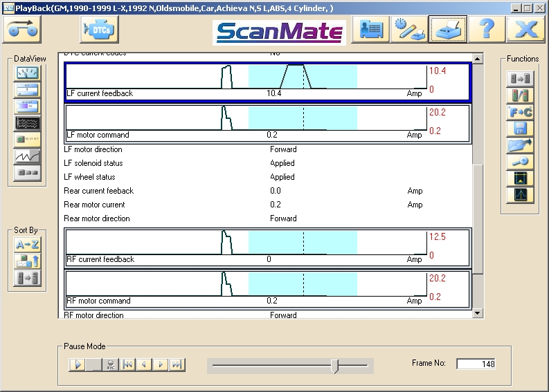

Cutlass350 Posted January 12, 2016 Report Posted January 12, 2016 Also, ignition modules (for just about all EFI cars) are notorious for doing what you're describing.If you wanted "to throw parts at it", I'd try that first. You can get a good OBD-II scanner with data logging for ~$100->$200 dollars. Heck, even my old scan-mate (it was $500+ when I got it) has good data logging. But, it does have a rather limited data capture amount. 1979lee 1 Quote
