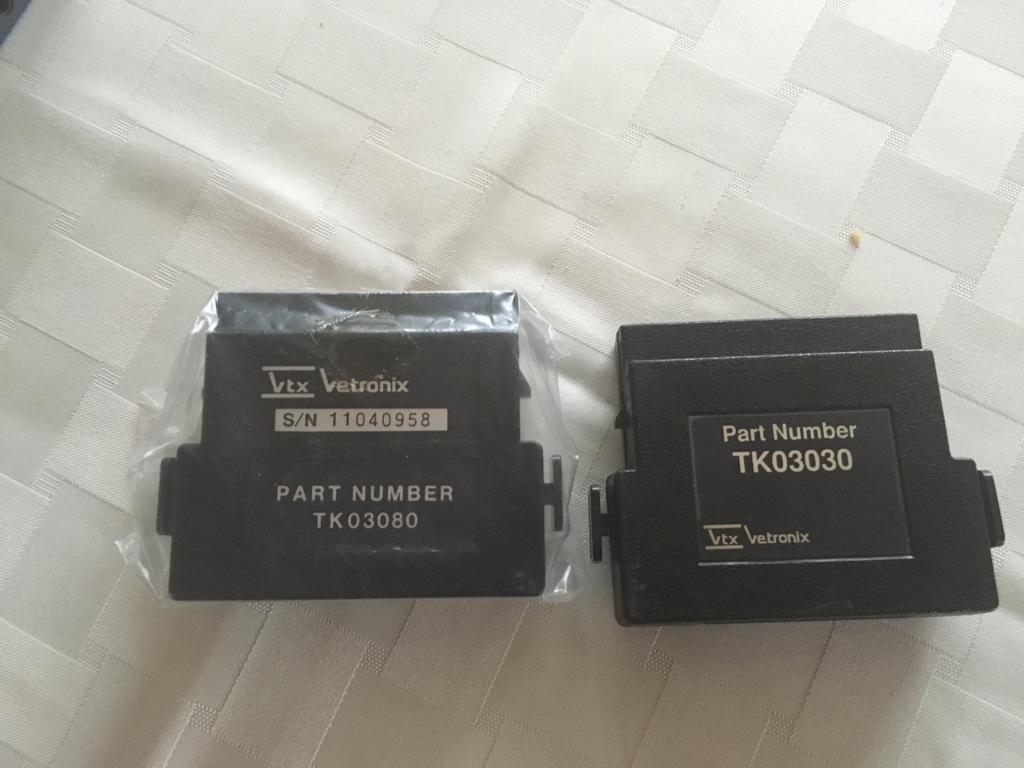

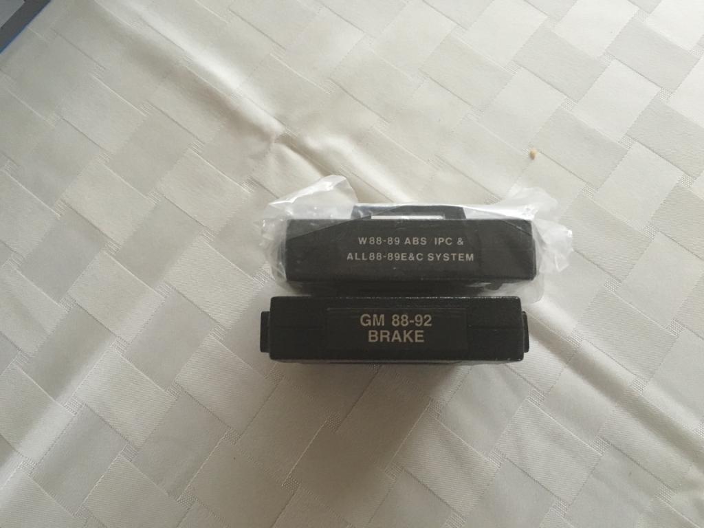

Heartbeat1991 Posted December 14, 2015 Report Posted December 14, 2015 These are the 2 I have. The one in plastic has never been opened. But that's the one from 89 that covers PMIII along with others. The 88-92 cartridge is the one I have used for PMIII codes. Works great. If you can't find one of these for a decent price, PM me. I can either sell you one or loan you one. Quote
