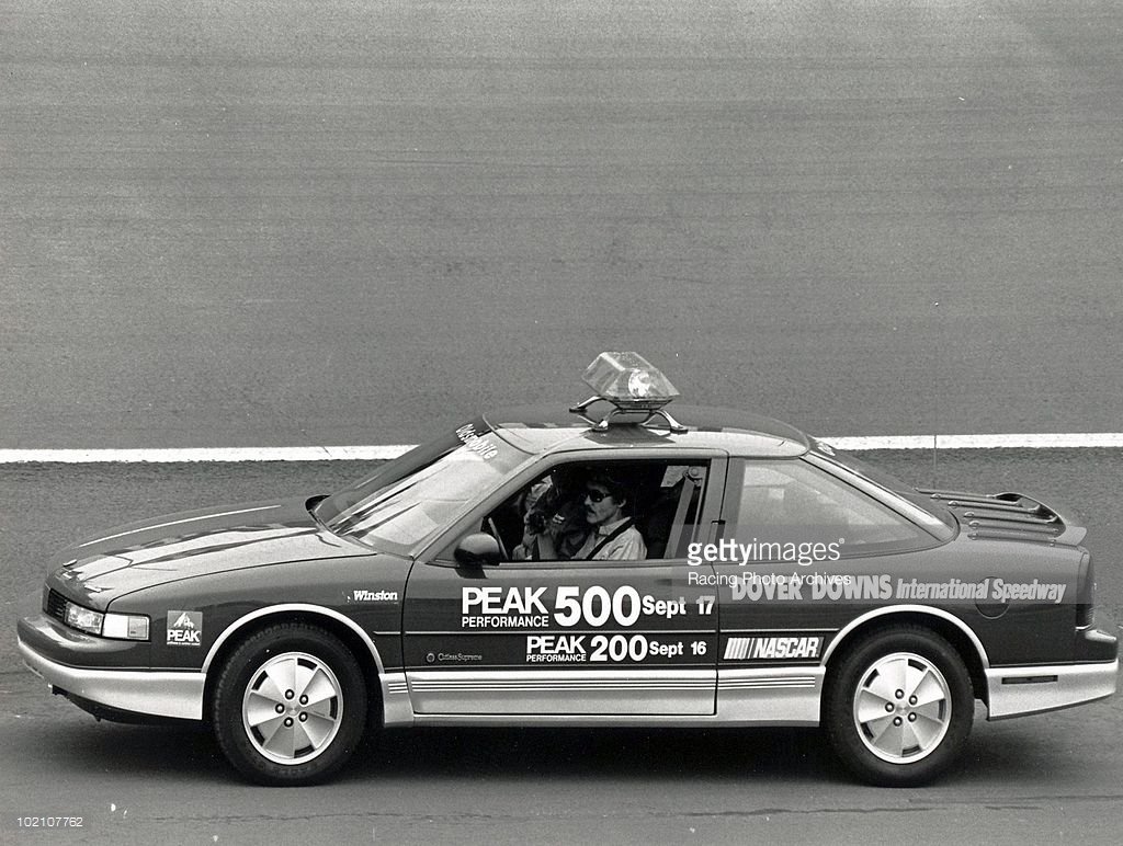

ManicMechanic Posted March 28, 2019 Report Posted March 28, 2019 I don't remember if I posted this or not. Yep, that's Richard Petty. jiggity76 1 Quote
jiggity76 Posted March 28, 2019 Author Report Posted March 28, 2019 How could you not love these cars! The wheels and the styling of that rear floating glass area, just awesome! Nas Escobar 1 Quote
jiggity76 Posted March 28, 2019 Author Report Posted March 28, 2019 I have yet to see one of these cars for sale anywhere, have you? Quote
