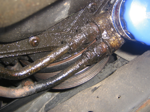

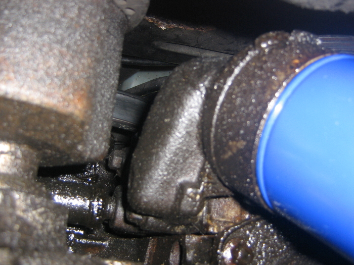

Under the Bonneville changing the oil and I found this, I don't know if this would want to co-exist with our front engine U-Brackets but nothing says the lines need to be run the same:
thats the early setup but a similar W body one is used on some well optioned 9c1 (police/taxi) impala's
Would this help oil last little longer, wonder what else we would need to add cooler to our wbodies.
That oil filter housing (with new gasket), or an aftermarket adapter, the hoses or lines, and a heat exchanger. And a good deal of patience with the oil pressure spring thingy install from under the oil dripping car, and band aids for your knuckles when you break those bolts free in that cramped little area.
