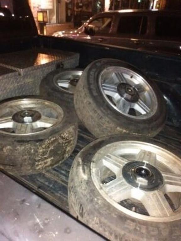

kingchase92 Posted October 31, 2015 Author Report Posted October 31, 2015 like witch ones for example? i was looking at a set of 18" dodge magnum rims for $100. what u think? 100 bucks seem fair for rims and tires? i got these ^^^^^^^ i hope they fit Quote
Psych0matt Posted October 31, 2015 Report Posted October 31, 2015 i got these ^^^^^^^ i hope they fitthats a great deal, though they're not my favorite. Quote
Imp558 Posted October 31, 2015 Report Posted October 31, 2015 the bolt circle should be right, hopefully the backspacing doesn't hit anything. all you can do is try Quote

Imp558 Posted November 1, 2015 Report Posted November 1, 2015 No, it's only 20mm. They won't hang out bad. More concerned with rubbing the calipers or struts Quote
kingchase92 Posted November 2, 2015 Author Report Posted November 2, 2015 No, it's only 20mm. They won't hang out bad. More concerned with rubbing the calipers or struts ur right i cant get the front rims on cuz of the calipers. im gonna get some wheel spacers for it and hope that works Quote
