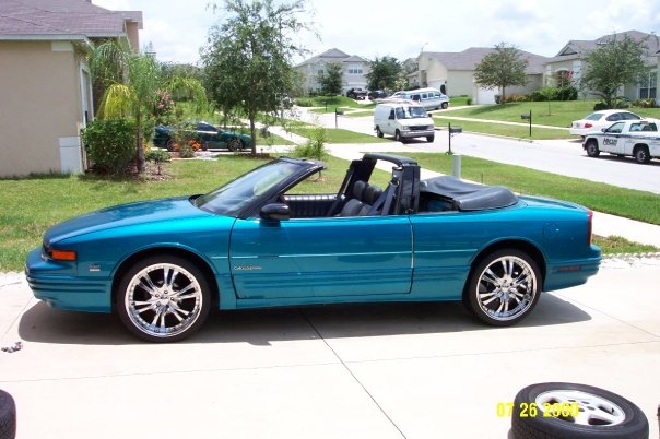

Bigdaddy000 Posted October 21, 2015 Report Posted October 21, 2015 This is my 94 with HUD and the 3.4 dohc LQ1 engine. Quote
Imp558 Posted October 21, 2015 Report Posted October 21, 2015 Wow, I love that color on a vert, welcome Bigdaddy000 1 Quote
94 olds vert Posted October 21, 2015 Report Posted October 21, 2015 I seem to remember this car. Anyways welcome back! Bigdaddy000 1 Quote
'93RegalGS3800 Posted October 21, 2015 Report Posted October 21, 2015 Nice to see an old member make a comeback. We could use some more veterans around here to bring some activity back to the forum. Bigdaddy000 1 Quote
George Posted October 21, 2015 Report Posted October 21, 2015 Did you buy the car back or just getting it back out? Sent from my iPhone using Tapatalk Quote
pshojo Posted October 22, 2015 Report Posted October 22, 2015 Chrome looks good with this color. Bigdaddy000 1 Quote
movielover40 Posted October 22, 2015 Report Posted October 22, 2015 Welcome back. Love that blue!! Bigdaddy000 1 Quote

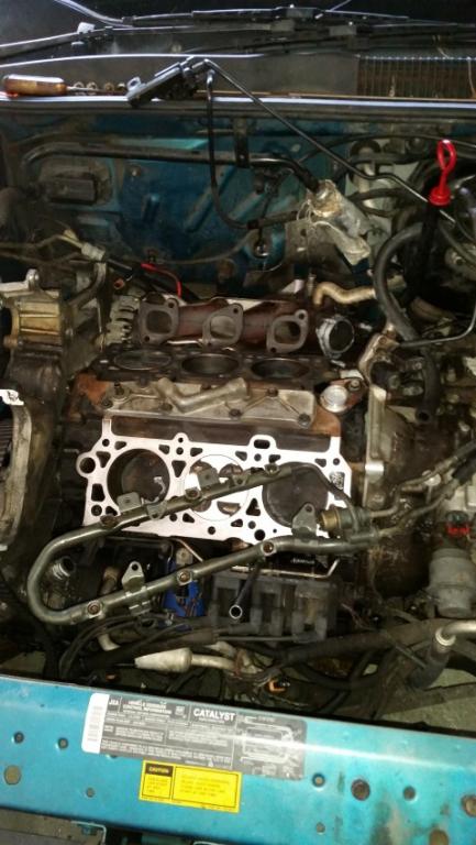

Bigdaddy000 Posted December 13, 2015 Author Report Posted December 13, 2015 Just got through doing a head gasket job on the 3.4. It wasn't as bad as it seemed to be. Once I finished, I grimaced and was scared to turn that key but SOB, started right up. No funky noises and all seemed good. So I changed the oil twice and the coolant 3 times. I've been using it daily and not 1 leak. LIFE IS GOOD. OBTW, the reason I had to do that was I overheated on a trip because the thermostat froze shut....I was pissed...heads were warped and my oil looked like a mocha frappe... Quote
GOT2B GM Posted December 16, 2015 Report Posted December 16, 2015 Been there, done that job..... car is looking good Quote
