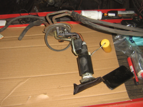

I'm not going to get into dropping the tank and re-installing, or even extracting the pump assembly from the tank aside from 2 things.
1) of the 3 lines in front of the tank, only remove the pressure and return, easily identified with quick connects at/by the filter. The line that is just coupled with rubber tube goes to the canister and passes right over the tank without connecting to it.
2) when re-installing the pump assembly watch tapping the lock ring, it's a bit smaller than it really could be and it has a tendency to unseat in one of the 3 places just before it's finally tight.

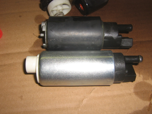

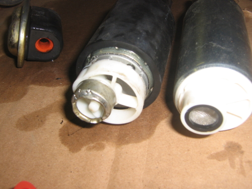

Okay, now my pump was already replaced with a Bosch pump, and there was a wiring adapter there but I ran the new one with the kit anyway. These comparison pictures are of the Bosch, which was sold as a direct replacement.

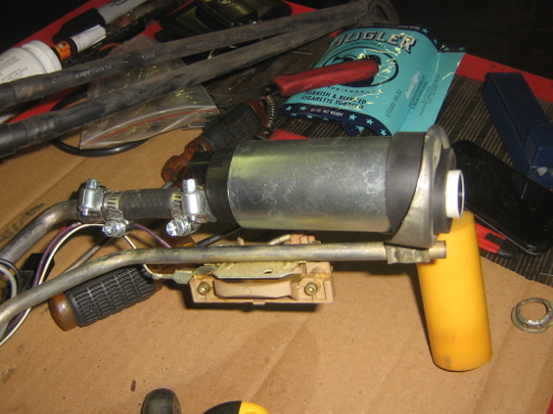

Here's the Bosch still on the pump assembly, also curious to see what you guys theorize that piece of machinery in the background is:

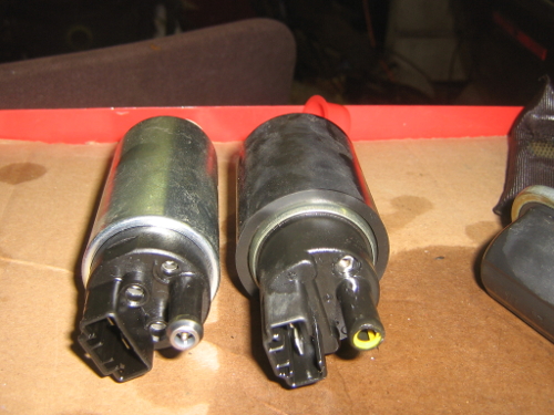

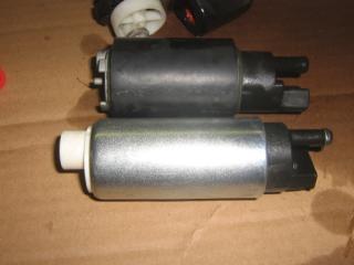

Here's a couple shots of both pumps side by side:
I said it was an easy swap, they're the same form factor.

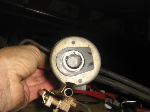

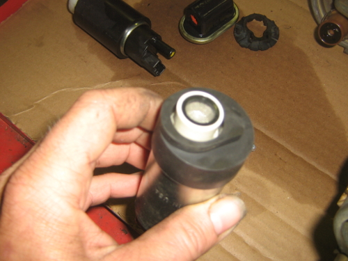

Here's the Walbro with the rubber grommet doodle they supplied, good fit on the bottom of our assembly:
The rest is just as obvious, cut the supplied hose and couple it to where the pulse dampener is attached. It came with 2 clamps so I pulled some out of a drawer and put 2 more on just for luck. To look at everything the pulse dampener could be utilized, but it's not exactly the most secure connection on that thing so the hose seemed like a better bet.

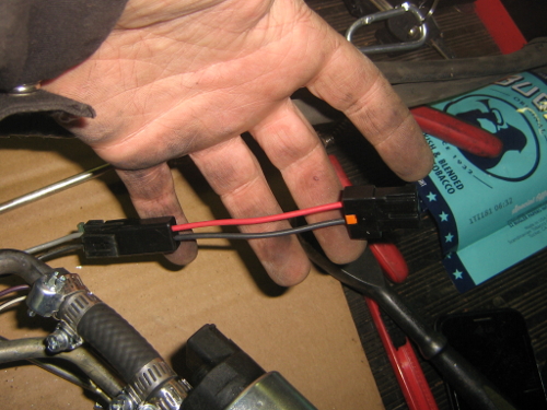

And here's a shot of the jumper plug thing that plugged right in to the car's existing fuel pump plug on one end and the Walbro on the other, the Bosch had the same thing:

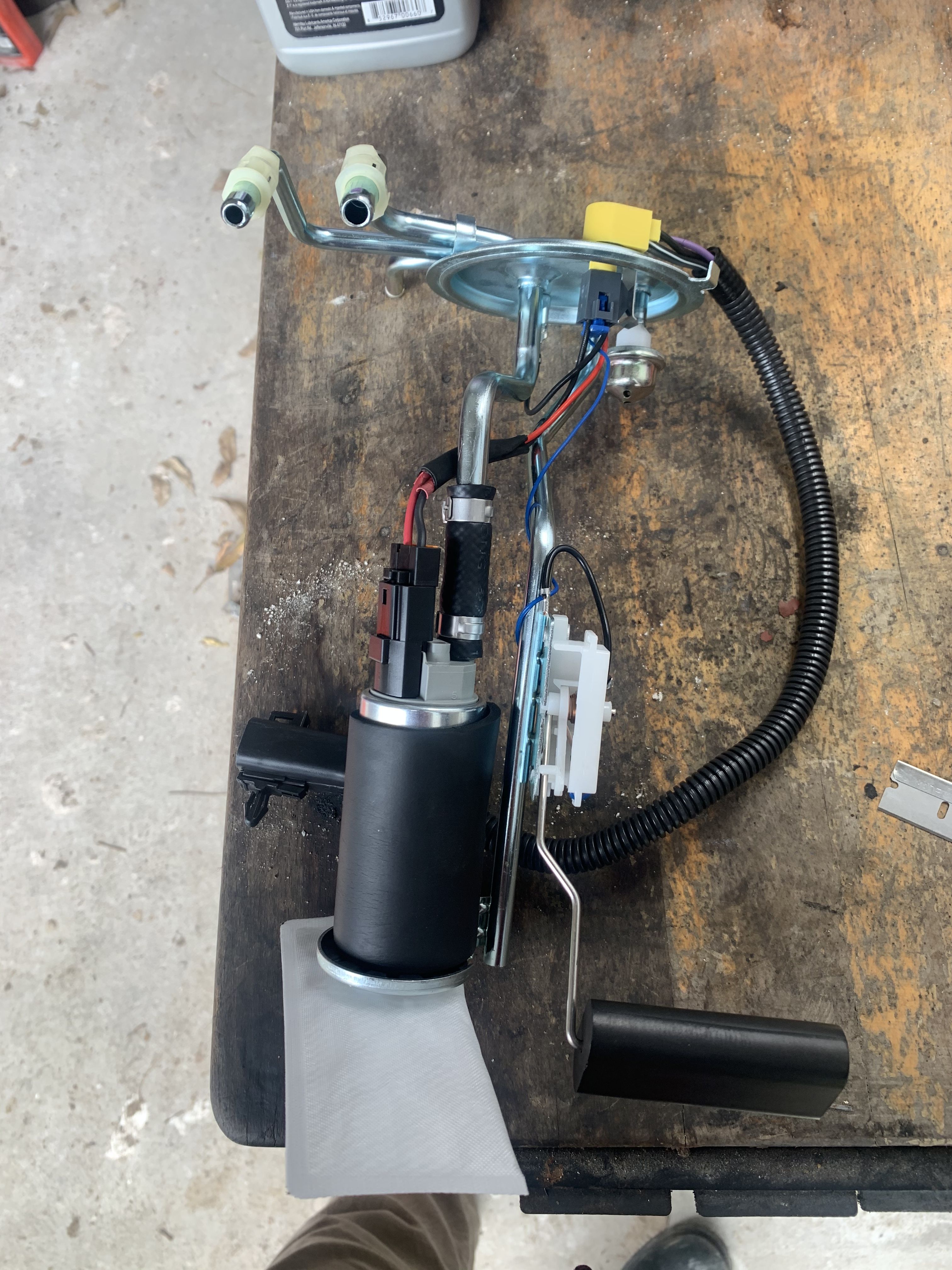

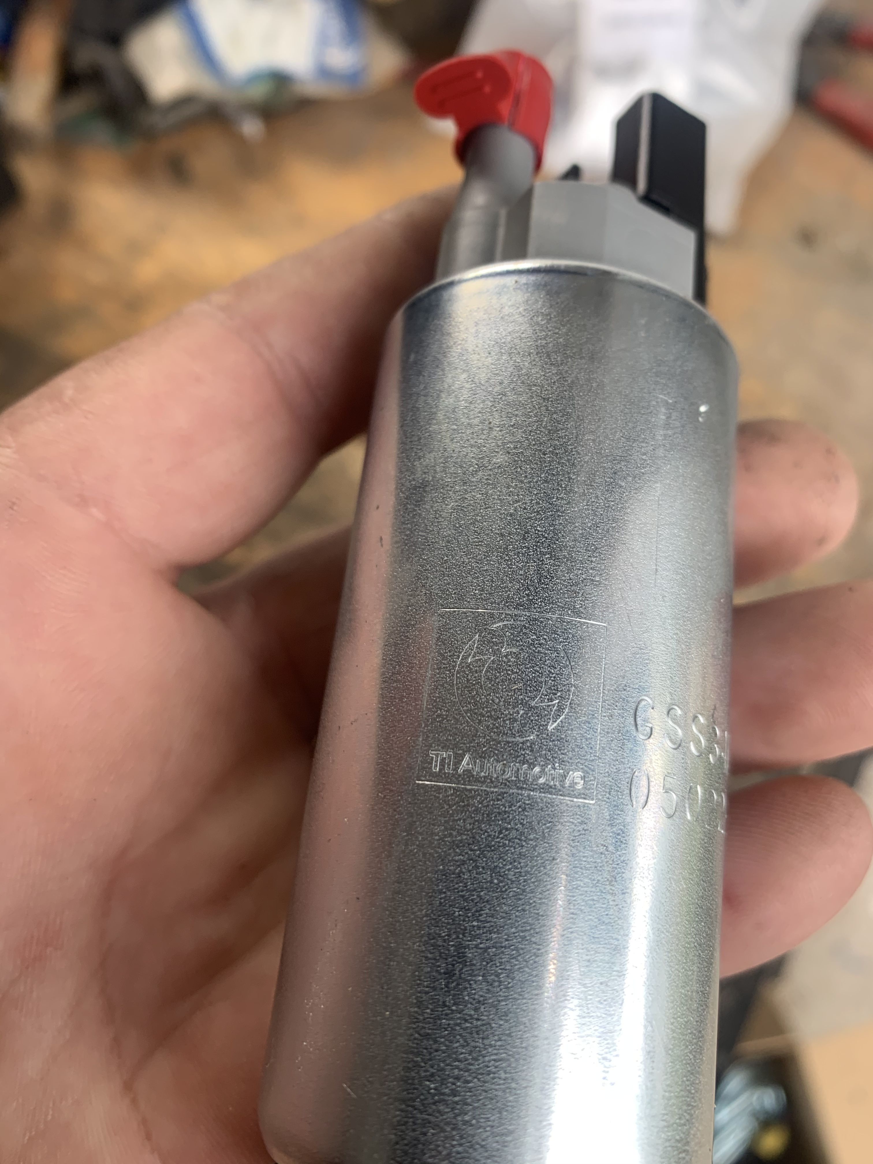

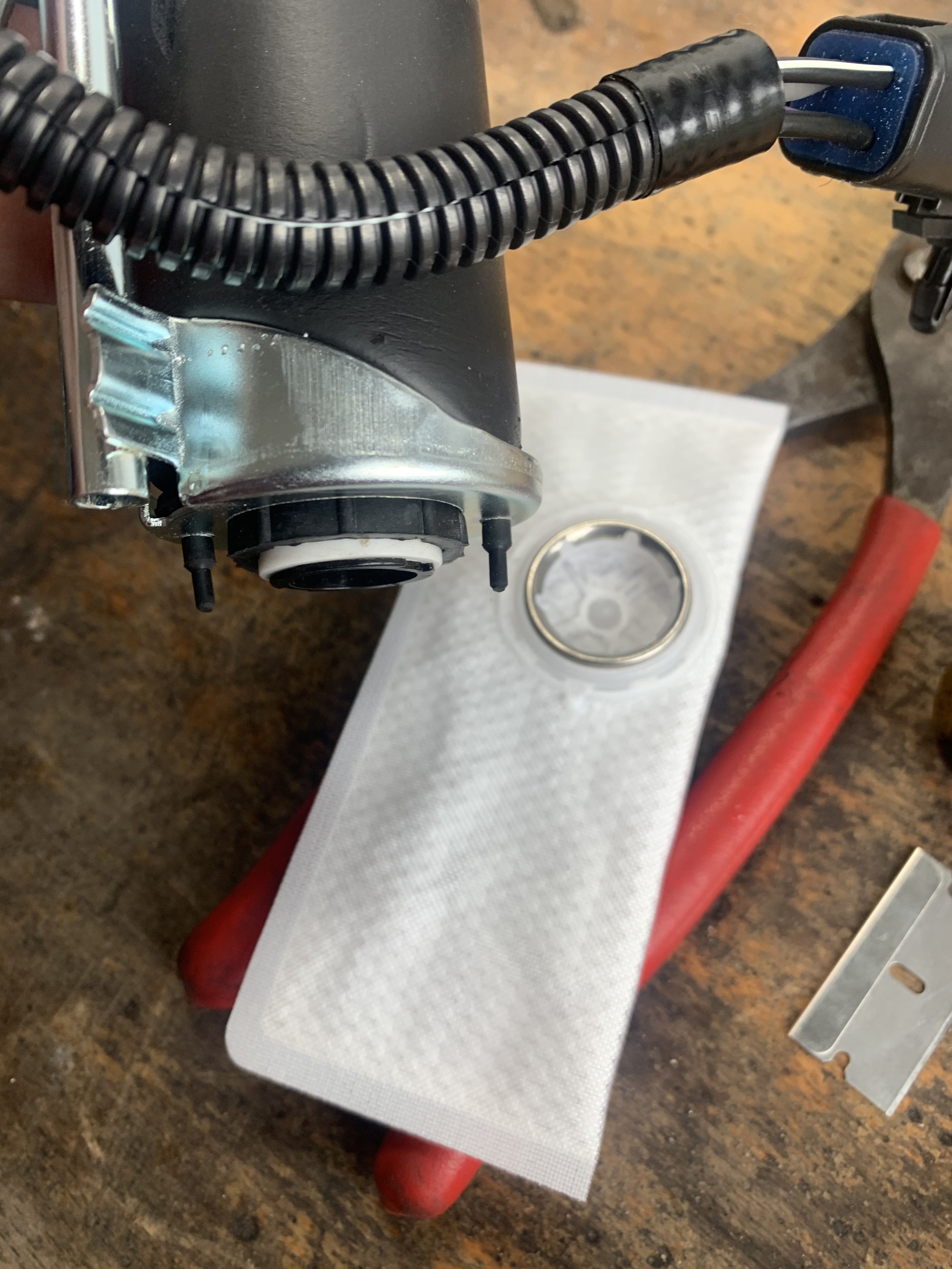

 I just installed a 225lph pump on a 94 lumina hanger. Took some slight fidgeting, but went on. It’s a TI automotive pump from LMR.com.    About $120 shipped
