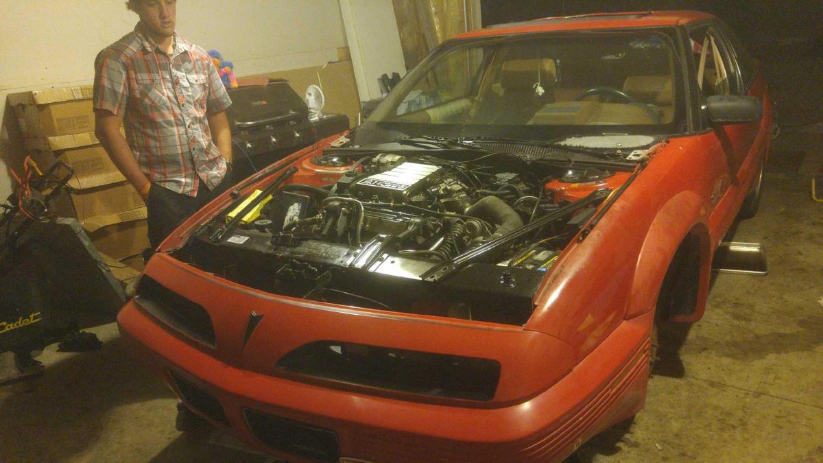

tgp1990 Posted September 24, 2015 Author Report Posted September 24, 2015 Front end is swapped after a fender bender from the previous owner but, I really like it. Quote
