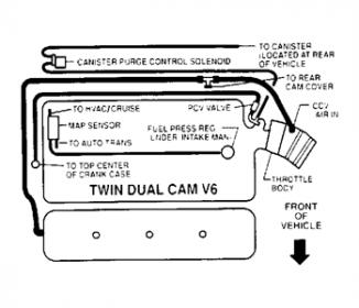

spiderw31 Posted July 7, 2015 Author Report Posted July 7, 2015 Oh, and if anyone happens to have a vacuum diagram it would be helpful. The original owner had a hood lock installed, and they mounted it right over the diagram on my car and ruined it Quote
carkhz316 Posted July 7, 2015 Report Posted July 7, 2015 Quick google search yielded this for vacuum diagram. I would have taken a pic of my Lumina, but it's since long gone. I would unplug the line leaving the MAP sensor going to the HVAC and cruise and check it with a vacuum tester. I'm guessing a chunk of the hard line that runs along the firewall or down to the vacuum ball is broken as I had the exact same issue on my '92 Z34 when I first got it. Quote

spiderw31 Posted July 8, 2015 Author Report Posted July 8, 2015 Thanks guys for the help! That vacuum diagram isn't complete, but at least let me verify which line was headed to HVAC/cruise. I found it was not seated well at the MAP sensor, and that improved the airflow a bit but not fully. I traced the line down from the cruise unit to the vacuum reservoir, and found it indeed had broken. Looks like it was leaky for a whiling when I moved the wiring around disconnecting the battery I managed to break that line. Patched it up, and air is better than it has been for a while! I'll test the cruise tomorrow, but I suspect it should be fine now too. Oh, and you were right Saar, the idle was a separate issue. Or more accurately I think a non-issue. I don't think I was patient enough this morning with the idle relearning process. By the end of the day it was much better and smoother. It may perhaps be a bit lower than before, but not by much. And yes, I swapped the MEMCAL into the new ECM. As a side note, the "new" ECM is actually quite old. Got it from Rock Auto, and it was remanned in 1997!!! They've definitely got some old parts sitting on their shelves! Quote
