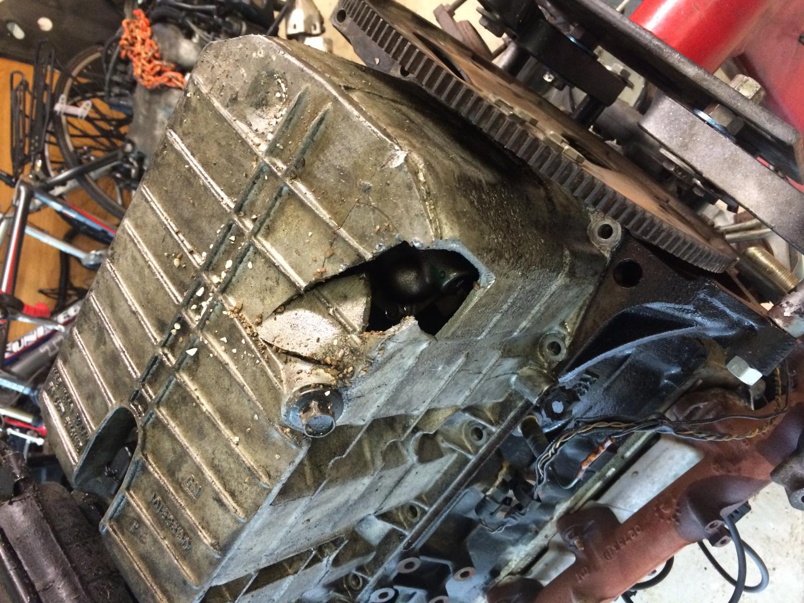

pshojo Posted June 14, 2015 Author Report Posted June 14, 2015 By the way, I knocked hole in the oil pan. . But when towed car to my place I ran the engine while we pushed it around to garage. Then noticed it had No oil. I should be ok with using this engine? Quote
Psych0matt Posted June 14, 2015 Report Posted June 14, 2015 when you say "no oil", do you mean "NO" oil, or it had lost a lot. You would usually hear if it's low enough to make a difference. If you ran it with no oil at all in it, I wouldn't risk it... Quote
pshojo Posted June 14, 2015 Author Report Posted June 14, 2015 (edited) I lost lot of oil, but by time it sat around, then moved the car around to the garage, I did see that engine oil was empty. Edited June 14, 2015 by pshojo Quote

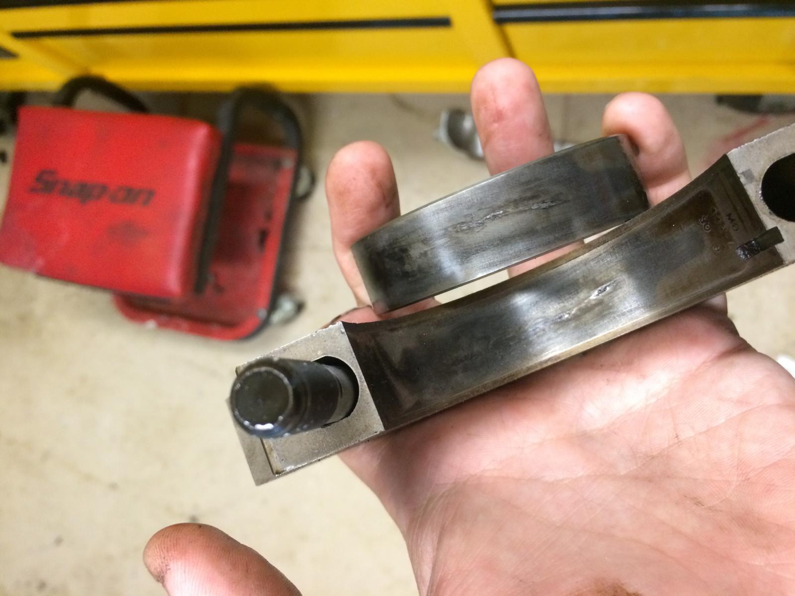

pshojo Posted June 14, 2015 Author Report Posted June 14, 2015 Well I did it, took pan off and took crank bearing out, the bearings have slight grooves, just to point that they catch my fingernail. The rod bearings looked great. So I'm thinking bearings are not any good. There were no shavings in pan. Thoughts? Quote
RobertISaar Posted June 14, 2015 Report Posted June 14, 2015 don't suppose you can post pics? if the journals look good and you didn't start burning into the bearing's backing material, I'd say you're just seeing normal wear. Quote

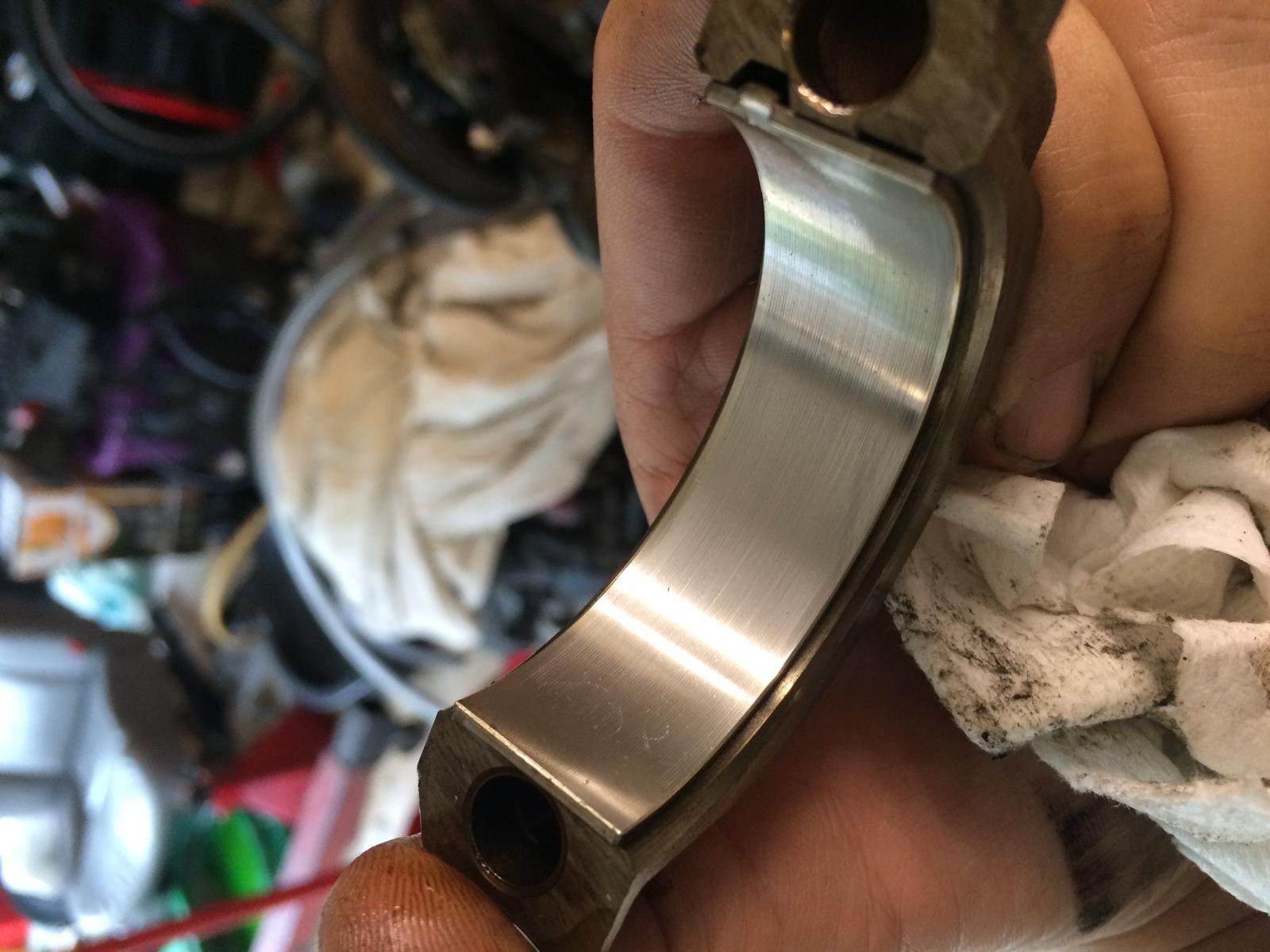

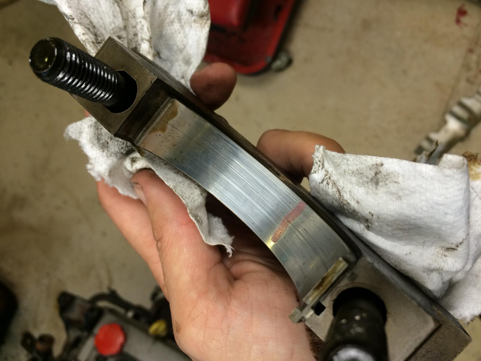

pshojo Posted June 15, 2015 Author Report Posted June 15, 2015 Pictures: Pan [ATTACH=CONFIG]18972[/ATTACH]Rod Bearing[ATTACH=CONFIG]18973[/ATTACH]Crank bearing [ATTACH=CONFIG]18974[/ATTACH]s[ATTACH=CONFIG]18975[/ATTACH] Quote
pshojo Posted June 15, 2015 Author Report Posted June 15, 2015 Hopefully these pictures tell enough. Quote
RobertISaar Posted June 15, 2015 Report Posted June 15, 2015 "invalid attachment" for every one I just clicked on. Quote
pshojo Posted June 15, 2015 Author Report Posted June 15, 2015 (edited) Try this... Crank Bearing Edited June 15, 2015 by pshojo Quote
vipmiller803 Posted June 15, 2015 Report Posted June 15, 2015 Damn that is one clean rod bearing. I agree that the main is not too great though. You might get away with just swapping main bearings, although some clearance measurements will then be in order. Assuming a more thorough rebuild is out of the question, if you have access to another engine, that might be best... Quote
RobertISaar Posted June 15, 2015 Report Posted June 15, 2015 I've certainly seen worse. I'd throw a new set of bearings in since they're a couple dollars/easily accessed and call it good. if you're feeling really nice, you could do the front and rear crank seals and the dizzy shaft seal(assuming they haven't been done already) and that would cover every common leak point as well. Quote
