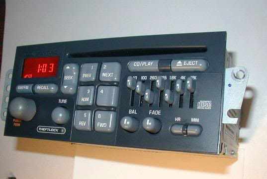

Heartbeat1991 Posted May 24, 2015 Report Posted May 24, 2015 [ATTACH]18884[/ATTACH] Are these rare? Not even a little. But mounting it will be a pain, and I'm not sure the SWRC works or even plugs in the same. Quote
dingles9 Posted May 24, 2015 Author Report Posted May 24, 2015 Not even a little. But mounting it will be a pain, and I'm not sure the SWRC works or even plugs in the same. Pls explain mounting. I thought all gm double dins were the same mounting bracket? Quote
Heartbeat1991 Posted May 24, 2015 Report Posted May 24, 2015 For starters, that's not a double din. But your car shouldn't have a double din anyway. Second, I don't recall too many GM radios mounting the same. The older ones it was just a matter of moving the mounting screws around on the frame of the radio. The newer ones are stamped steel mounts, as seen in your picture. You can cut those off, but you'll still need to come up with a way to mount it to your dash. Quote
Heartbeat1991 Posted May 24, 2015 Report Posted May 24, 2015 The newer style bonneville's had a similar dash and used the style radio you posted a pic of. There may be a way to make that work, but you'd get better results on an H-Body site for Bonneville info. Quote
Nas Escobar Posted May 25, 2015 Report Posted May 25, 2015 Pls explain mounting. I thought all gm double dins were the same mounting bracket? Actually they're DIN 1.5, which basically means they're bigger than a normal radio but smaller than a normal 2DIN. The brackets are different because the W bodies had a removable bracket on the bottom but this radio has brackets on the side. You could dremel them off but you still have to deal with making a bracket. Sent from my SAMSUNG-SGH-T989 using Tapatalk Quote
jman093 Posted May 28, 2015 Report Posted May 28, 2015 [ATTACH]18884[/ATTACH] Are these rare? Heartbeat is right. They are everywhere. And his suspicion on the SWRC not working is warranted. That is a later generation of radio that used a different SWRC system. You would have to find like a TGP CD player or some other late 80s/early 90s GM CD player like this: http://www.ebay.com/itm/GM-RADIO-CD-PLAYER-IPOD-3-5mm-AUX-86-87-88-CHEVY-MONTE-CARLO-SS-EL-CAMINO-DELCO-/201341414217?vxp=mtr Quote
