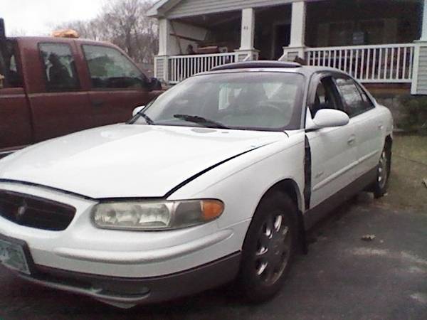

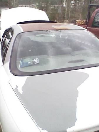

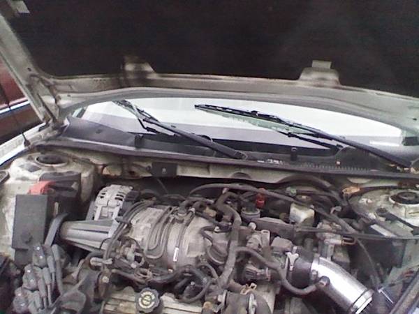

Ok so the 98 is in picked it up today. drove back 2 hour ride drove nice but rear end banging probably struts.peeled back rocker covers and rust poured out.everything else seems ok as far as rot. ran good even without a battery.post-11365-143689181506_thumb.jpg
