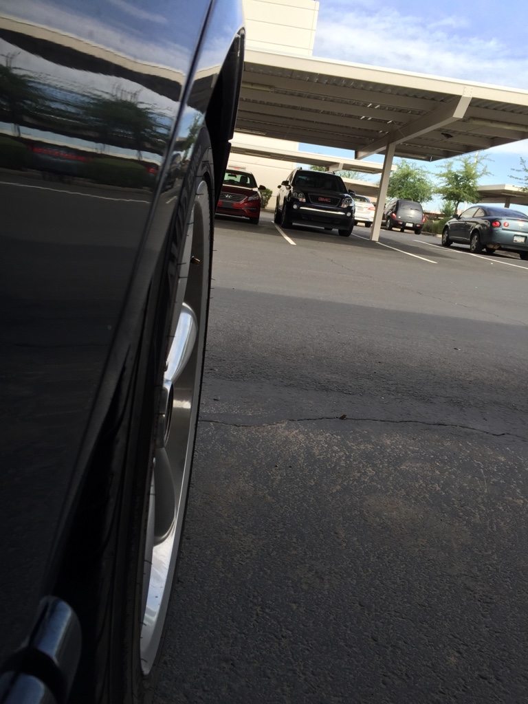

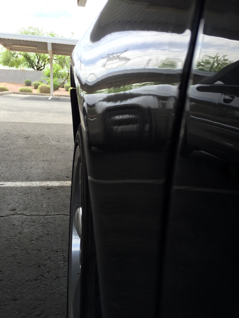

Will 18 x 8.5 + 35 wheels wrapped in 245/45/18 rubber fit on a 2001 GTP?
I'm wanting to say yes.
I do know 18 x 8 +38 wheels with that tire size fit a 1G no problem
If those specs are for the 077s I had that set up on my old mgbm gtp and they fit wit no problems.....I wasn't sure if the 077 stats though.
They will fit i have 18x8.5 +50 with more than enought room for a lower offset
