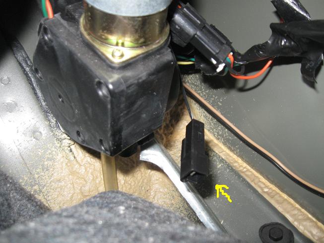

Have looked in my trunk for the black & white wire to reprogram the key fobs can't seem to locate it, are they hidden under the deck lid sometimes? Or do I need to look elsewhere?

That programming wire is hiding on the right hand side behind the electric antenna motor.
Thanks for the help it ended up running along the top passengers side of the trunk almost where the wires dip to go to the tail loghts. The end was barely sticking out.
