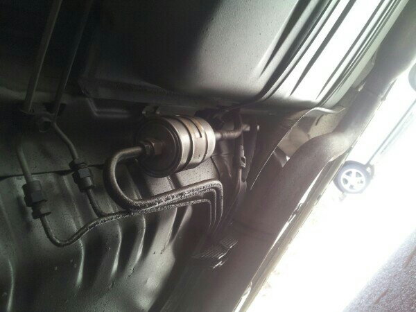

Hey guys, 95 vert 3.4, 172,000 miles usually runs pretty good. The other day I started it and it shut right off. Started it again and it revved up to 4000 rpm and slowly died out. Started it again and kept my foot on the gas and it wouldn't rev higher than 4000 rpms and started to sputter if I tried to go higher. Kept foot on gas steady for about 3 minutes, then slowly let off and it was fine. It seems to only do this in the morning or after sitting for a few hours. It runs fine after it stays started. Btw..where is the fuel filter on this car. Thanks in advance for any ideas.
Look for the gas tank, you'll find it there.

Fixed. My mechanic said he cleaned the throttle body and did something to the iac. He only charged me $80 and the car runs great. Thanks for the suggestions and to Nas Escobar, thanks for the fuel filter pic.
