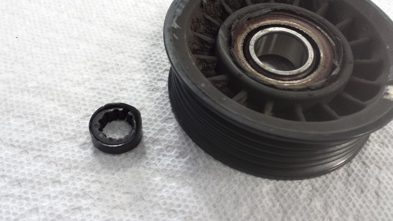

While on my way to work my car decided to spin a grooved idler pulley bearing for the Supercharger. I did manage to limp it into a KIA dealership parking lot nearby and wrenched off the offending pulley.
The SC belt was damaged severely and the accessories belt had some minor damage. I have to replace both now. The pulley is a write-off but what 'wierds' me out is the plastic bushing which I cannot find or reference (in the picture below to the left of the pulley).
If you look closely the plastic bushing has an outer shell that sheared off leaving half inside the mounting bracket on the engine. I am assuming it stands off so that when you replace the pulley, bell washer and bolt the bell washer faces up with the bushing. Can anyone help me out with this? Does this bushing come out completely and is it replaceable or is this a part of the bracket to which it is attached. I don't want to put this back on but I am between a rock and a hard place. I may just size up the bushing and stick a PTFE or NAB sleeve in it's place (something with a better P & V, and temp tolerance than this).

Ya dont need it. Also instead of the stock pulley use an alt tensioner pulley...same size and offset only its steel

I already bought the replacement plastic one. I did not know you could use an alternator pulley. I made the assumption it was 1/4" smaller in ⌀. Well I will be jamming this bugger on in -20*C weather with windchill and no cover. So yeah it's gonna be fun

Mebbe return it and swap for steel? Yeah my monte has never had the plastic one since i supercharged it
The bushing appears to be no more than a guide to keeping the bell washer tight to the flanged bolt. Everything went together without a hitch. It would have been easier to have three arms for the task in general.
