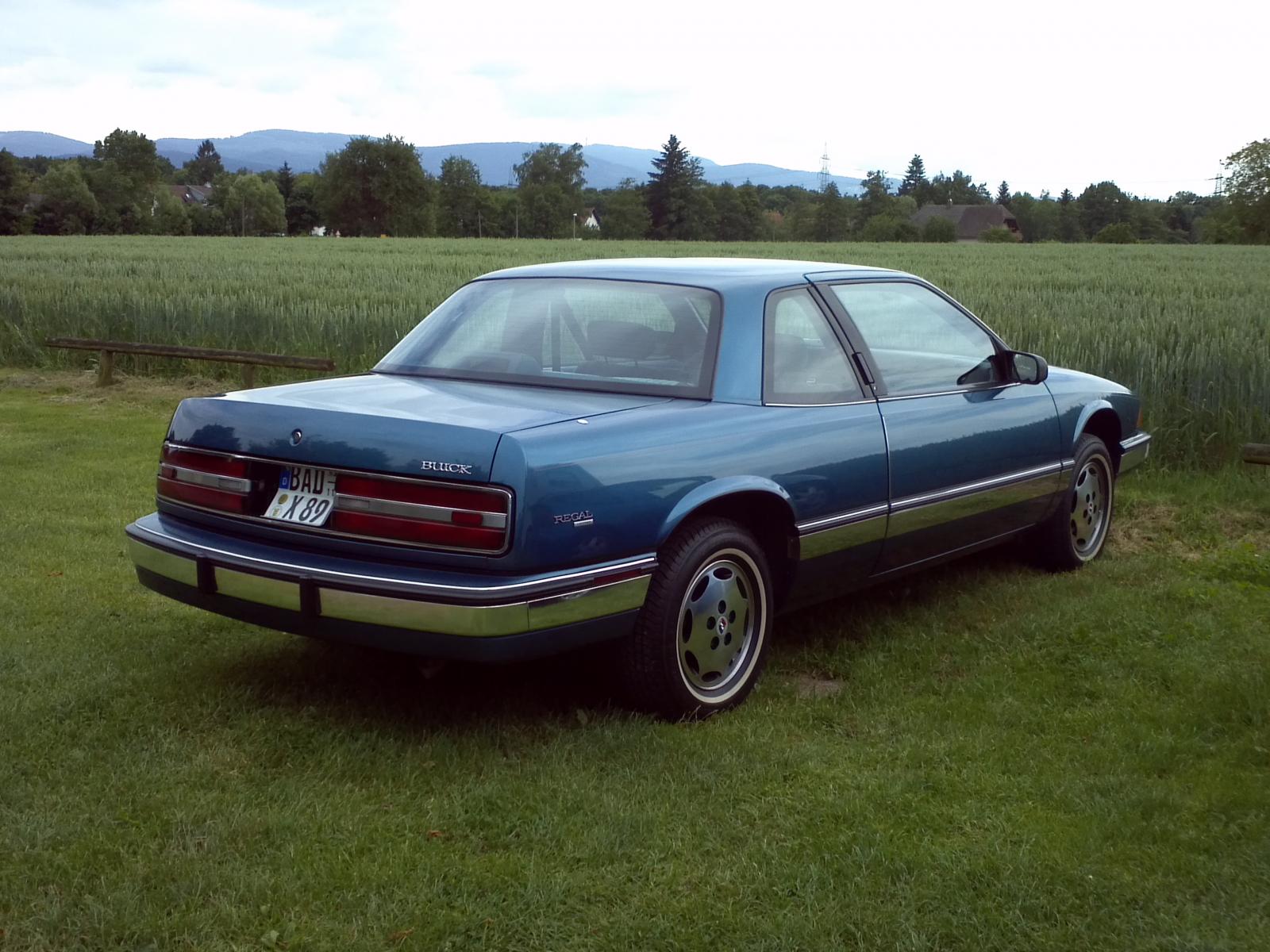

pitzel Posted March 23, 2015 Report Posted March 23, 2015 (edited) Any 5W-30 or 0W-30 will work just fine in these engines. I personally have run over 60,000km on the same oil, a reasonably high quality synthetic with no detrimental results. There's no turbocharger in the LH0, and its a pretty easy engine overall on oil. Keep an eye, of course, on quantity, and make sure you investigate coolant leaks thoroughly as the 60 degree V6's are notorious for lower intake manifold leaks. p.s. how fast can you make that thing go on the autobahn? Edited March 23, 2015 by pitzel Quote
HEMI-V8 Posted March 25, 2015 Author Report Posted March 25, 2015 The regal is limited at around 112 mph (180 kmh). Im a very gently driver with the buick, so i have tried it once only. Quote
