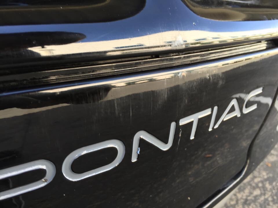

jake91 Posted May 6, 2015 Author Report Posted May 6, 2015 You practice incest?? That's soooo weird man. How can you even think about doing your mom?!?!?!?!????????? Well we know where your sick mind lays lol The clear bra is to late now im a moron and alread messed up the paint. I thought i had the car backed into the garage enough and closed the door on it Quote
Nas Escobar Posted May 6, 2015 Report Posted May 6, 2015 Well we know where your sick mind lays lol I'm not the one that forgot the English language is full of innuendos. The clear bra is to late now im a moron and alread messed up the paint. I thought i had the car backed into the garage enough and closed the door on it Did you dent the car or just scratch it? I'm pretty sure most of it will buff out. I had a similar incident with a post in a parking garage. Scraped the bumper on my Camaro, bought a buffer and it came right out. Quote
jake91 Posted May 6, 2015 Author Report Posted May 6, 2015 Took it down to primer and plastic Sent from my iPad using Tapatalk Quote
jake91 Posted May 6, 2015 Author Report Posted May 6, 2015 This is why I can't have nice things Sent from my iPad using Tapatalk Quote
Nas Escobar Posted May 6, 2015 Report Posted May 6, 2015 It looks like the filler plate would buff out. The rest could be fixed with the scratch fixer thing duplicolor sells. Sent from my SAMSUNG-SGH-T989 using Tapatalk Quote
