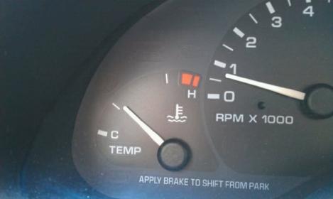

post-9075-143689178126_thumb.jpg Thanks for the reply. I will try to disconnect the sensor and see if the fans come on. Am I correct in assuming the gauge should stay at the lower line where it is pointed now?
thats where it should be at normal operating temperature
[ATTACH=CONFIG]18420[/ATTACH] Thanks for the reply. I will try to disconnect the sensor and see if the fans come on. Am I correct in assuming the gauge should stay at the lower line where it is pointed now?
You can go as far up as the center of the C and the H. As long as the needle doesn't get to the last white notch you're good. These needles aren't accurate, hence some people calling them "dummy gauges".
