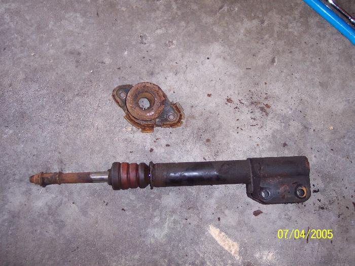

DiscoStudd Posted February 4, 2015 Report Posted February 4, 2015 Ive got this looming in the future but I haz no air tools. I think I`m going to sucker down and replace the hub assembly while im down there as well as get my Z34 bar, and Got2BGM lateral links on there and I still need to paint my RTSB and solid trailing arms to match everything. IIRC those large knuckle bolts are torque to yield correct? Also since you've just done this, if you plan on changing the mount do you even need to bother with removing the old one from the old strut?Knuckle bolts are reusable. Don't bother reusing the upper mount. YES this job can be done without air tools, but you'll definitely need a cheater bar to break the knuckle bolts nuts loose. Also helps to have a 13/16" deep well socket to get those nuts off. I did a post on this a looooooong time ago, can't find it to save my life... Quote
DiscoStudd Posted February 4, 2015 Report Posted February 4, 2015 Here's why you don't reuse the upper mounts: Quote
