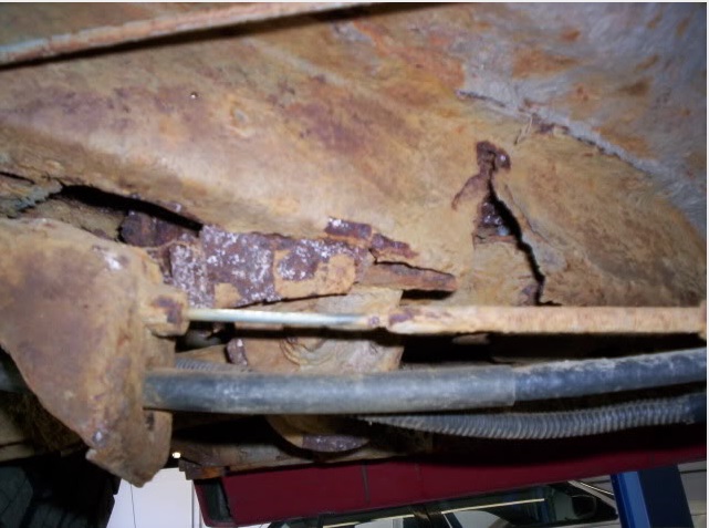

derkach99 Posted January 19, 2015 Author Report Posted January 19, 2015 Ok, just another quick question that worries me about the car is that on the frame of the car just in front of the rear wheels I have some frame rot. It worries me a bit because as a result my mechanic asks me how much are you willing to spend in the car. I tell him I am planning to make the car a summer car and he says that's a good plan but I am afraid its going to cost alot to repair this rot when I get around to it. I believe there is still lots of strength in it though. I am just worried. Quote
GnatGoSplat Posted January 20, 2015 Report Posted January 20, 2015 My 94 whines when cold too. As long as the fluid level is normal and there are no leaks, I don't worry about it. Give the suspension parts a good shake and see if the trailing arm mount is solid or not. If it wobbles like it's going to come off, then it's not safe to drive and needs to be repaired. I've seen plenty of pics posted here of the mount completely busted off. No idea how much it would cost to weld in a new mount, but it doesn't sound cheap. Quote
derkach99 Posted January 20, 2015 Author Report Posted January 20, 2015 My 94 whines when cold too. As long as the fluid level is normal and there are no leaks, I don't worry about it. Give the suspension parts a good shake and see if the trailing arm mount is solid or not. If it wobbles like it's going to come off, then it's not safe to drive and needs to be repaired. I've seen plenty of pics posted here of the mount completely busted off. No idea how much it would cost to weld in a new mount, but it doesn't sound cheap. At this point I would say that they are solid especially notable during very cold weather when the rear suspension is stiff.(i think because the mono leaf spring is frozen solid.) My dad used to jack up the rear of the car from the knuckle of the trailing arm. Would undercoating prevent the rotting from progressing? Quote
55trucker Posted January 20, 2015 Report Posted January 20, 2015 Temp really has no bearing on the state of the chassis, those two boxes rot from the inside out, what you see on the outside is less than whats going on inside, if YOUR situation is this bad.......(this a generic photo) you need to get that addressed, as stated above fabrication costs money, you'd need to speak to a qualified welder (or a the very least someone who is experienced enough/comfortable doing this) who would be interested in tacking the job. Quote
derkach99 Posted January 20, 2015 Author Report Posted January 20, 2015 Temp really has no bearing on the state of the chassis, those two boxes rot from the inside out, what you see on the outside is less than whats going on inside, if YOUR situation is this bad.......(this a generic photo) you need to get that addressed, as stated above fabrication costs money, you'd need to speak to a qualified welder (or a the very least someone who is experienced enough/comfortable doing this) who would be interested in tacking the job. So thats what that bolt does, its holds up the speed censor wire. mine is about the same as that but instead of a hold on the side there is one at the bottom, but this is just a box?? Quote

derkach99 Posted January 20, 2015 Author Report Posted January 20, 2015 Yeah, I think that's a park brake cable. no that just holds up the abs speed censor wire, that hanger is gone on my car but the brake cable runs just to the inside of that toward the middle of the car. I find it amazing that my parking brake is still functional. Quote
55trucker Posted January 20, 2015 Report Posted January 20, 2015 So thats what that bolt does, its holds up the speed censor wire. mine is about the same as that but instead of a hold on the side there is one at the bottom, but this is just a box?? that *box* is a structural section, the car's regular sheetmetal is in the neighborhood of 20 gauge (.035), these are approx 14-12 gauge (.083-.109), you look closely at that shot of the forward trailing arm *eye*, it has been used as a jacking point, and you can see it has folded over and as well broken thru and collapsed the box. Not pretty, foolish on the part of whoever & how many times in the past the trailing arm was used to lift the car. Expensive to rebuild..... Quote

derkach99 Posted January 20, 2015 Author Report Posted January 20, 2015 that *box* is a structural section, the car's regular sheetmetal is in the neighborhood of 20 gauge (.035), these are approx 14-12 gauge (.083-.109), you look closely at that shot of the forward trailing arm *eye*, it has been used as a jacking point, and you can see it has folded over and as well broken thru and collapsed the box. Not pretty, foolish on the part of whoever & how many times in the past the trailing arm was used to lift the car. Expensive to rebuild..... Broken through the box? mine has folded over lips like that one does. there really seems to not be a good place to jack up the rear of the car. My cutty is going to be put away next winter this is the last one! mine just has rust holes in the bottom the other side looks noticeably better. Also that is a speed sensor wire because one of mine started to come off the bottom of the car and got yanked off my the tire, im in need of a new one, the wire hugs the trailing arm like that one does complete with the plastic covering. Quote

derkach99 Posted January 20, 2015 Author Report Posted January 20, 2015 (edited) the silver cable is the parking brake cable. The black wire or cable below it i can't remember what that one is for. Edited January 20, 2015 by derkach99 Quote

55trucker Posted January 20, 2015 Report Posted January 20, 2015 Broken through the box? Do you not see the edge where the steel has severed? The upward pressure of jacking on the bottom of the trailing arm support there has pushed the trailing arm support thru the rotted box. The proper location for a lifting pad is the area in front of the support where there is vertical strength in the sides of the box (or there would be in a healthy car), but whoever is lifting the car has to watch for the emerg brake cable & the small wire loop that holds the park cable right there & in the case of an ABS car that sensor which is in the same location. Get sloppy & one can squeeze the park cable with the weight of the car and crush it & also destroy the ABS sensor wire. Quote
derkach99 Posted January 21, 2015 Author Report Posted January 21, 2015 Do you not see the edge where the steel has severed? The upward pressure of jacking on the bottom of the trailing arm support there has pushed the trailing arm support thru the rotted box. The proper location for a lifting pad is the area in front of the support where there is vertical strength in the sides of the box (or there would be in a healthy car), but whoever is lifting the car has to watch for the emerg brake cable & the small wire loop that holds the park cable right there & in the case of an ABS car that sensor which is in the same location. Get sloppy & one can squeeze the park cable with the weight of the car and crush it & also destroy the ABS sensor wire. im confused so the trailing arm is suppose to be under teh box not in it? Quote
rich_e777 Posted January 21, 2015 Report Posted January 21, 2015 ^ correct, if that is the underside of your CS, then you need major metal work done and it is dangerous to drive. Quote
