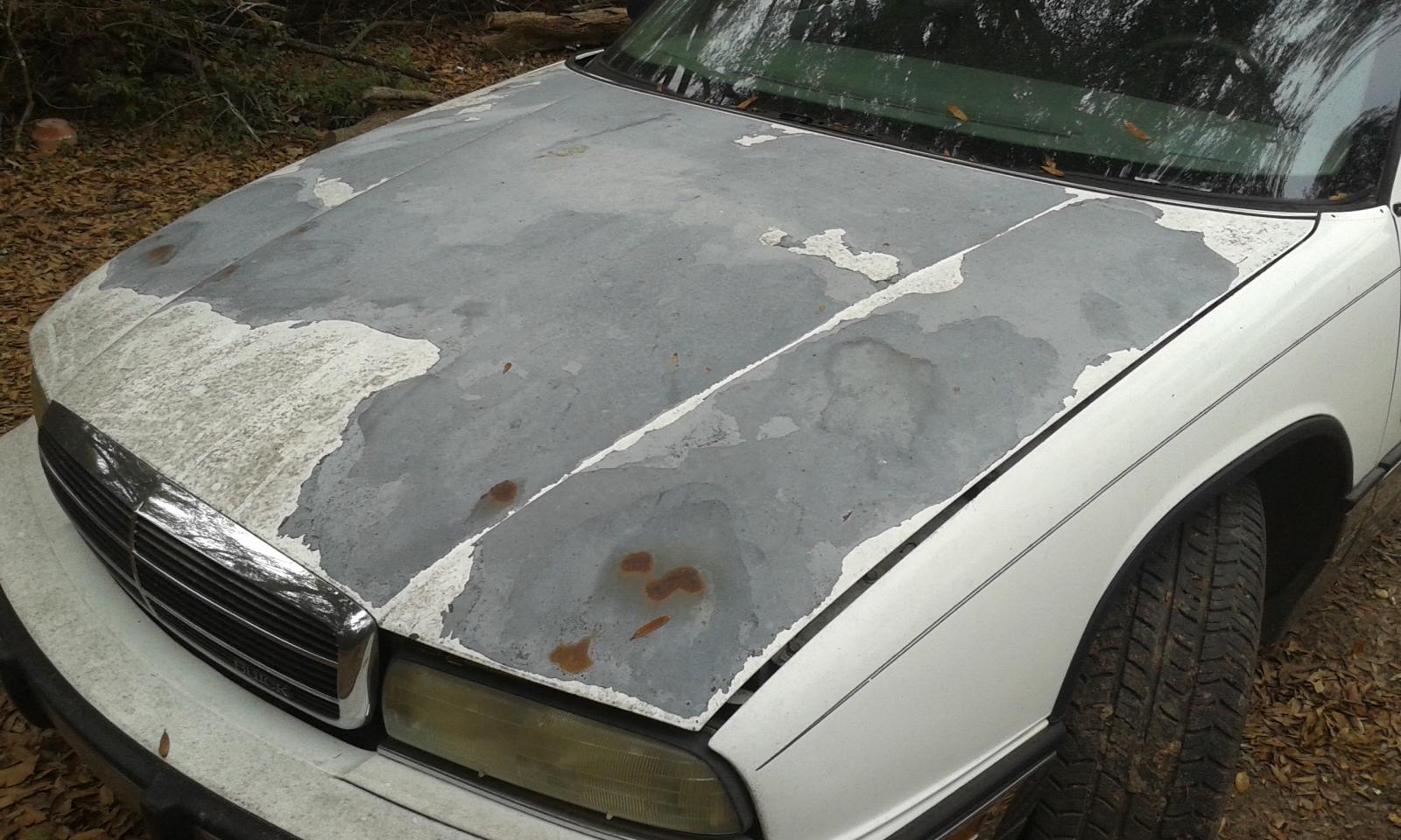

I've been pondering about repainting my Buick for some time now. The car was brought down from Arizona to Florida at the turn of the century. I remember first seeing her and how she shined bright white in the sun. Fast forward to the end of my Freshman year of highschool and the horror begins.

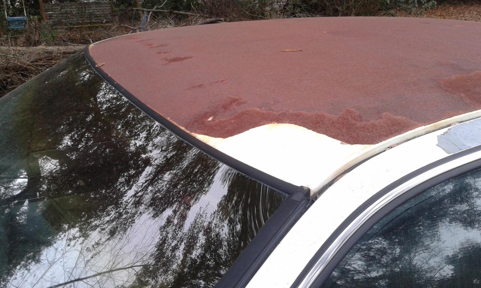

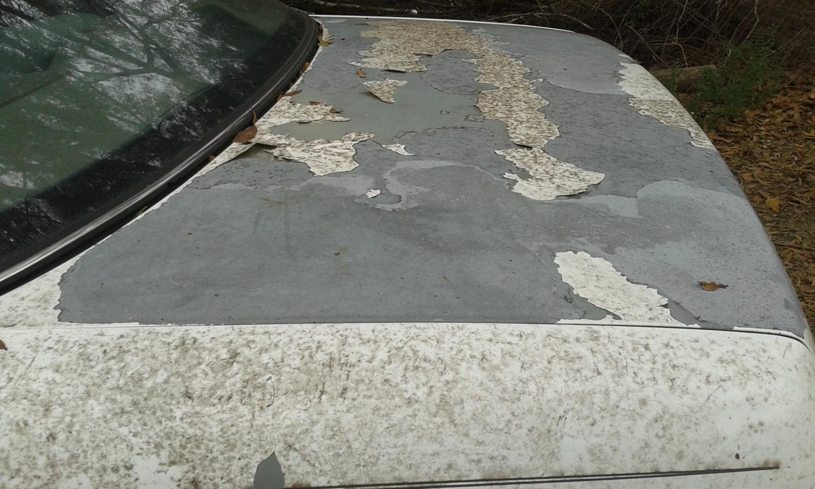

It started on the roof of the car. A little patch of surface rust and some peeling paint. That would eventually take over the entire roof. The hood and trunk started to peel after the roof. The problem areas are on the top of the car but now there are issues starting on the tops of the rear quarters with peeling paint.
I find this car intimidating to paint with the ammount of trim there is to remove and tape off. I'm also worried about having to pull the fixed glass and cleaning up any channels under them to kill any speck of rust. Knowing where I stand all the exterior molding will have to come off.
If I had the tools and place to do it I'd give this car a full unibody strip and restoration, but right now that isn't feasable. I need an alternative to keep this car going untill I can get a place to do that.

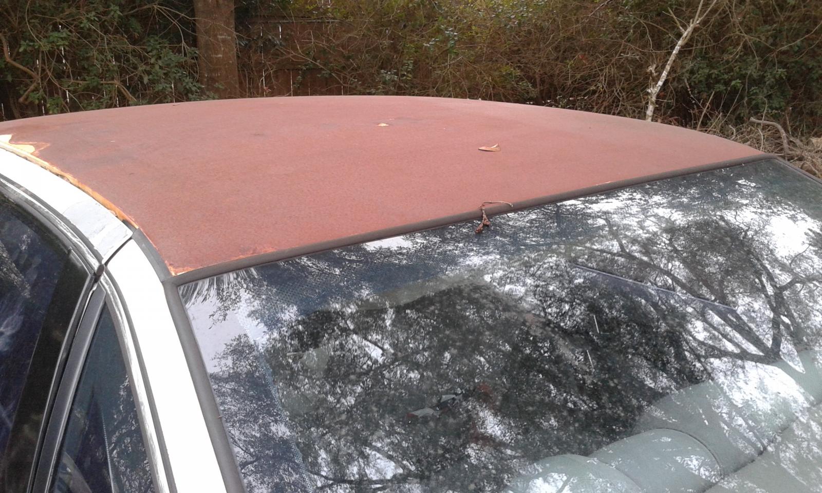

That roof is pretty bad. IDK if it would be more than just "surface rust" and you have to be prepared to have to do actual body work. That roof may be SOL.
Other than that, Aircraft stripper, a lot of sanding, and if you can get your hands on air tools, then a paint gun and 2 or so gallons of primer and paint. The duplicolor gallon paint isn't very expensive ($25 or so at Auto Zone) but the paint gun will be the hardest thing to do. I also would suggest practicing using a paint gun before painting the car. You don't want runs on it.

Sand the roof down to bare metal and hope you dont have any rust through points. If you dont get it primed and painted.
If you do there are two options get it patched with new metal. Or bondo it up. Its just a roof not that noticible compared to a fender.
These cars arent worth much I would bondo it.

You wouldn't be cutting the car' date=' what would happen is that when you sand down the roof and you get to bare metal, there may be chunks of it that are so thin and weak that they just come off. You can usually tell on the metal how weak it really is. When you press down on it, it should still feel solid. If it feels like smoosh then the metal is done.
I thought about taking a drill with a wire wheel on it and grind the rust off that way. I tried a sander before but it wasen't really working out.
That is another method, just be sure not to cut the metal. Also with some sanders you still have to use sandpaper on the disc. Usually 40-80 grit will cut through rust.

If you don't feel confident about your skills, then I recommend you paint a panel at a time. The most important thing is for you to strip all the paint off the trunk and hood as those areas seem the worst hit with the paint peel ad go from there. If you can find a cheap used air compressor, I'd go that route to paint the car with a paint gun. It will be 100 times easier than using rattle cans. Rattle cans are not made for painting whole bodies. IT can be done but it is very tedious.

The biggest thing with bondo is not going crazy with it and making sure it's flush with the car. I don't think you'll have to tear apart that whole roof but hopefully you can find something to loosen up all that rust.

If the whole roof is gone, then that's not a bondo job anymore, that's a weldng job. You would have to get a roof cut from a junked regal and you would have to have someone else weld it on for you... which isn't out the norm. I know someone on here had some big weld job on their TGP.
If you're sure it's only surface rust, hopefully you can get away with sanding it off, although you may have to bondo it a bit, but that would be different than making a whole new piece from scratch. You could technically fiberglass the whole roof but getting the shape of it would be hard.
