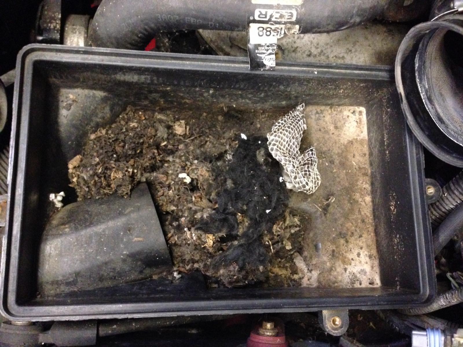

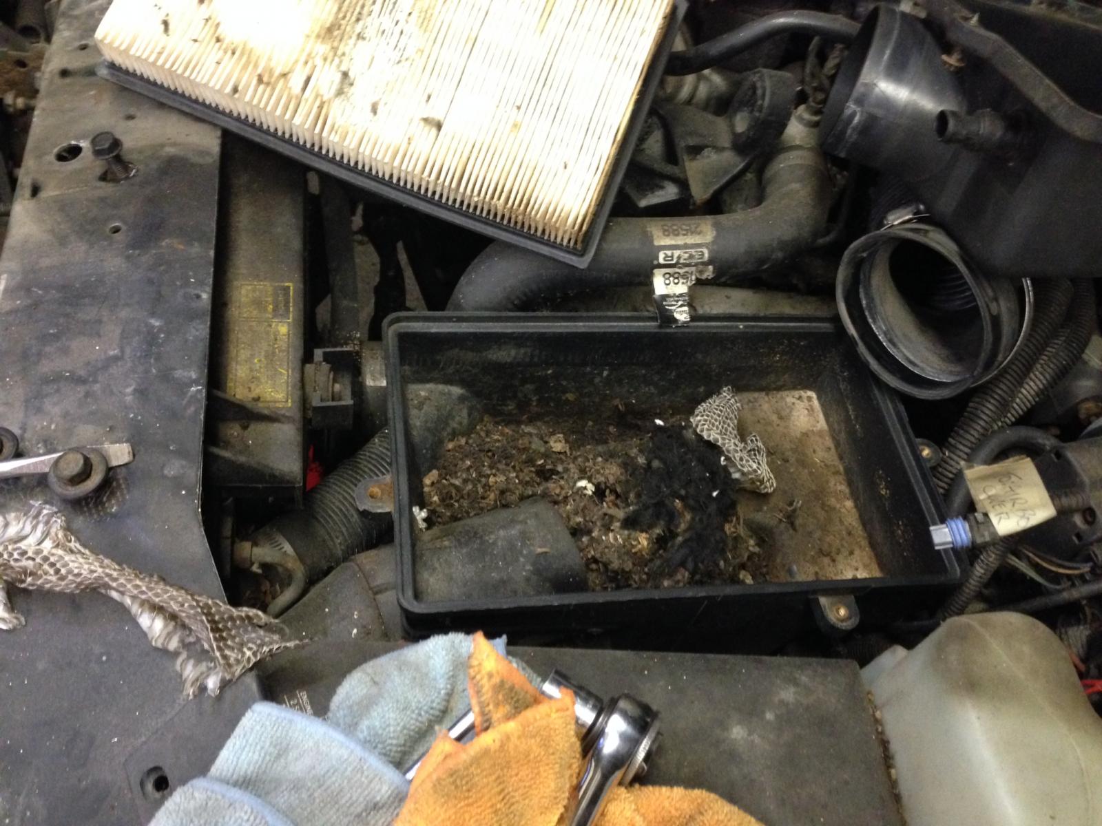

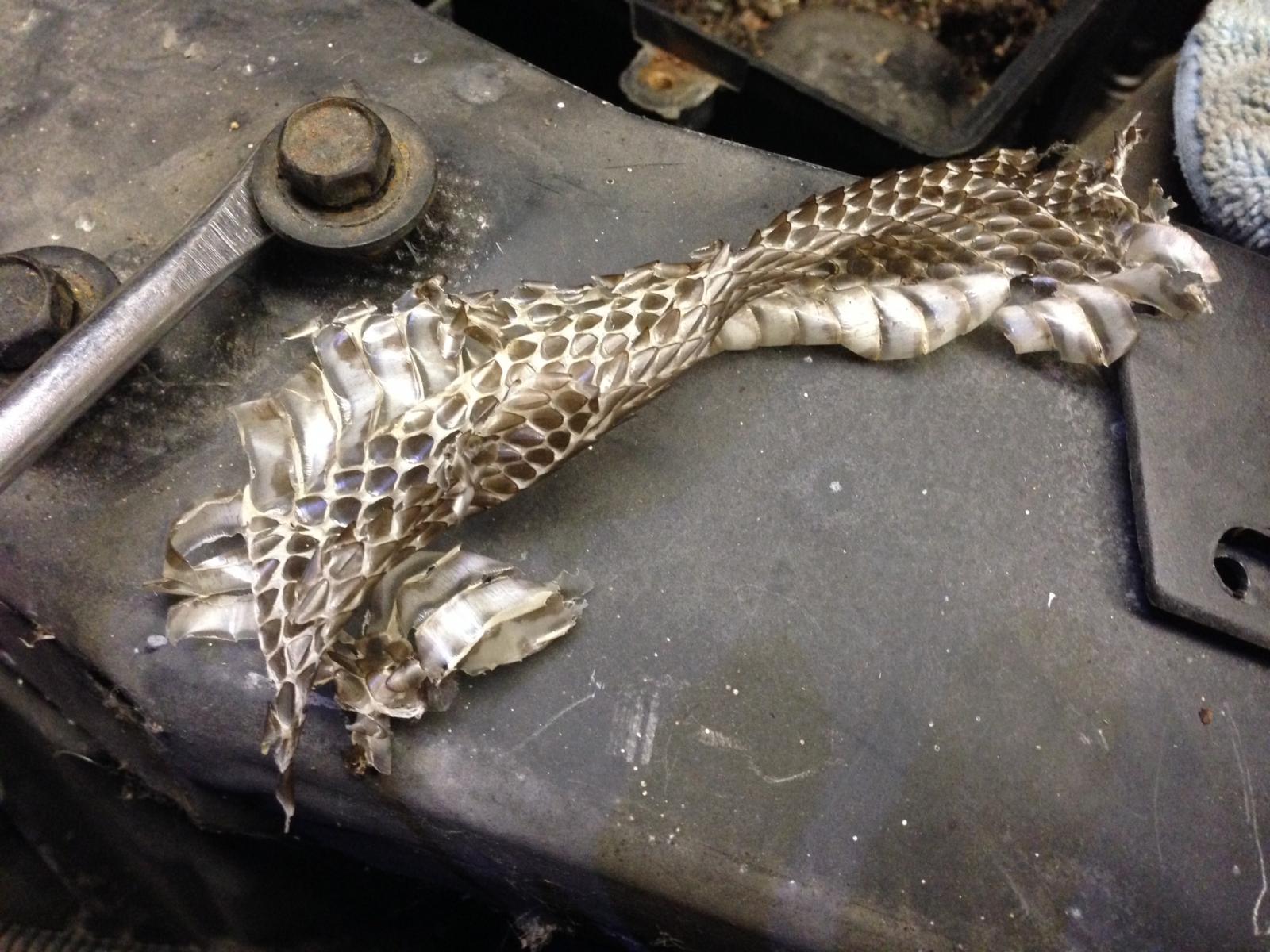

kingkarmann Posted January 5, 2015 Author Report Posted January 5, 2015 Figured I would have to replace all the fluids and filters. I know of at least 1 filter that has to be replaced.... I'm figuring mice got in the airbox and used the filter to make a nice little nest. Along came Mr. Snake and made a nice meal from them. Mr. Snake left me a little souvenir! The little rodents also thought the hoodliner material makes great nesting material...... I'm really going to need to check the wiring closely!! Quote

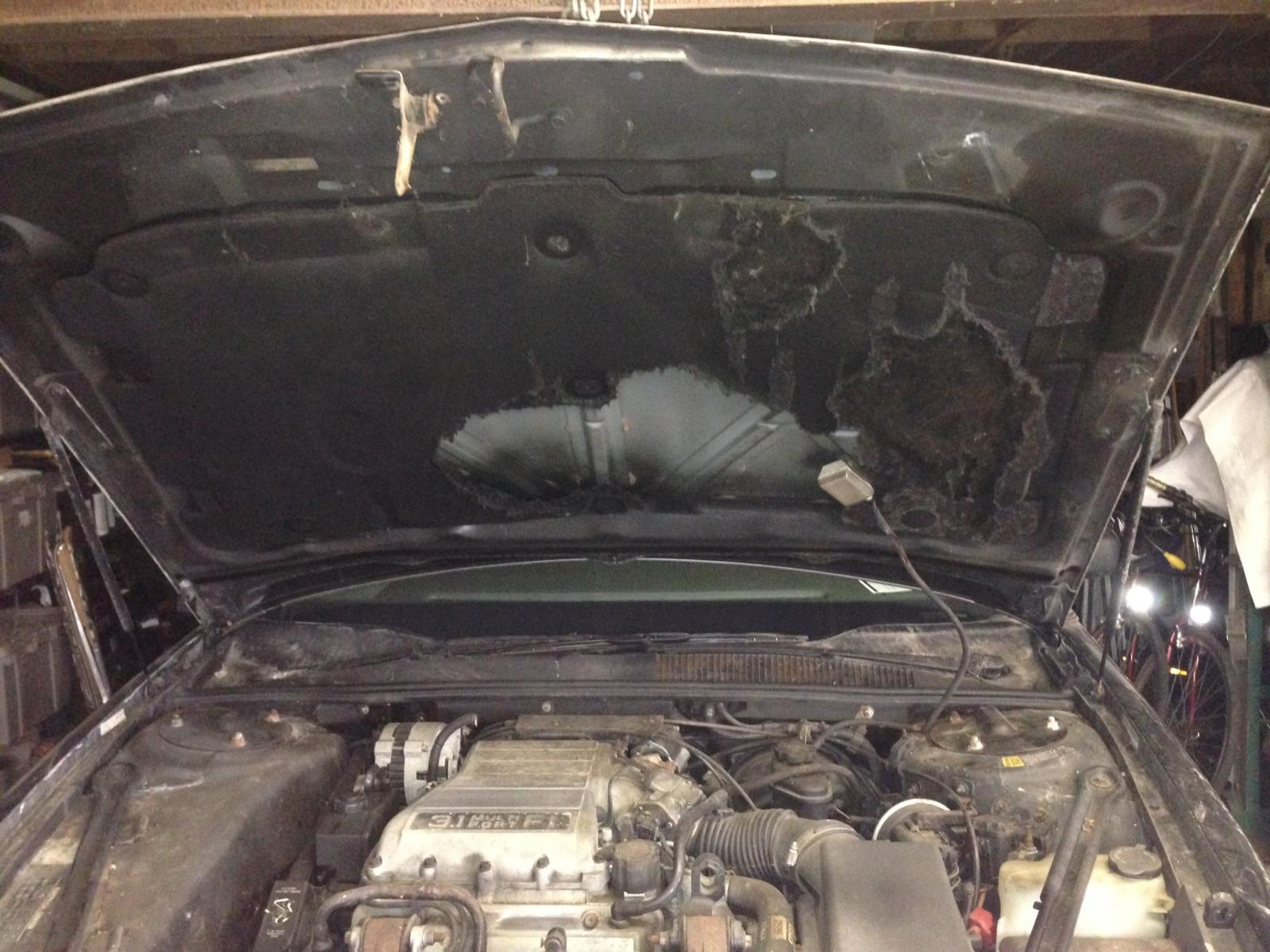

kingkarmann Posted March 16, 2015 Author Report Posted March 16, 2015 We had some decent weather over the weekend. After the artic blast passed I decided to get back at it. I have most of the top end of the engine dis-assembled and started a list of things to be repaired, refurbished or replaced. Pulled the cowl of and removed the wiper assembly. Found another huge mouse (rat) nest under it. Cleaned that all up. I'll post u some more pics soon. Quote
