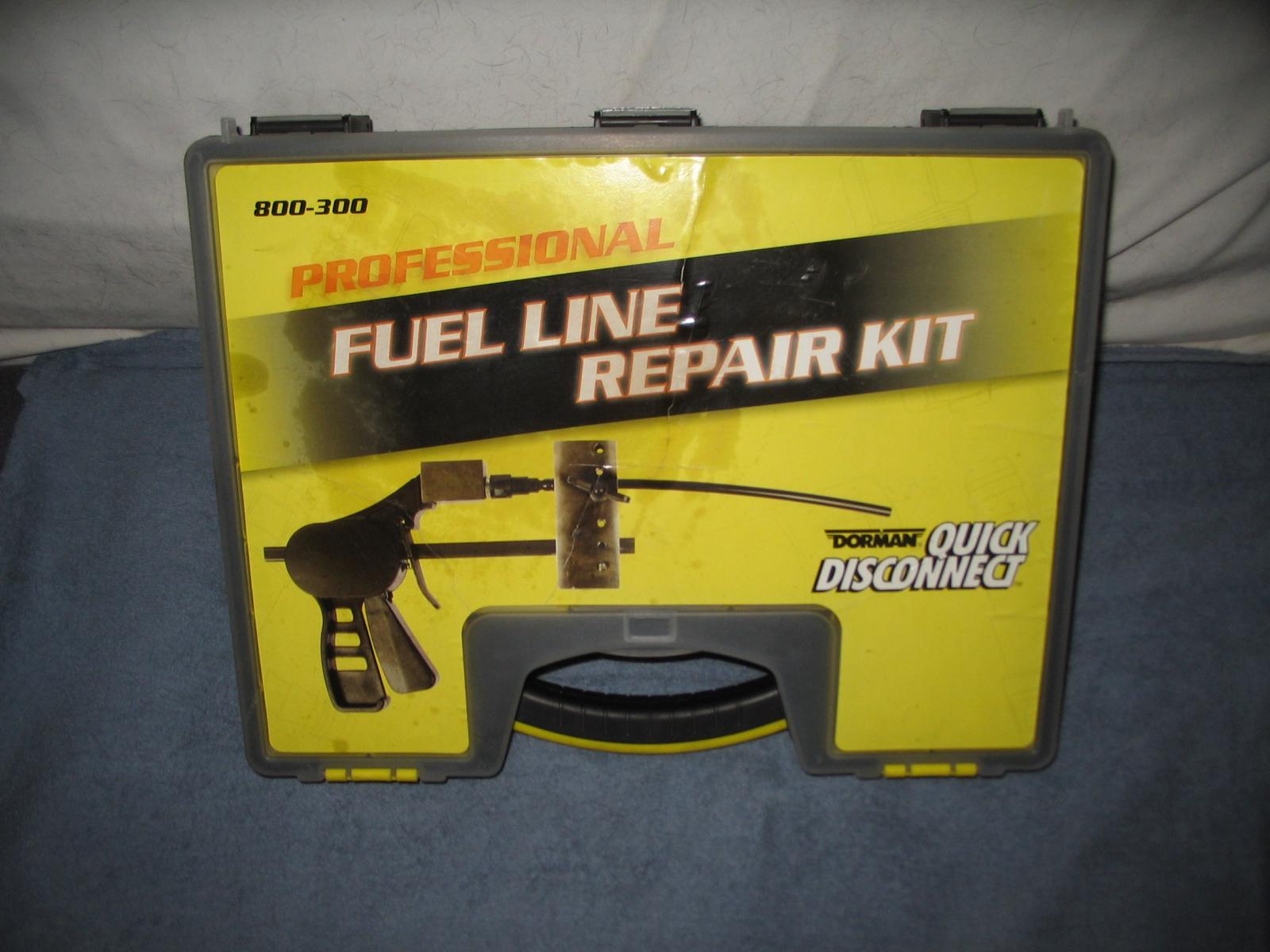

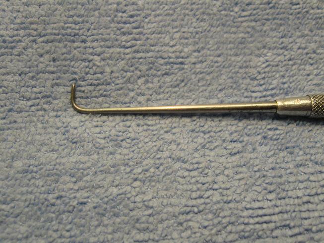

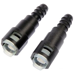

That plastic connector has two o-rings inside that seal the plastic to the steel fitting. So if the plastic connector or plastic gas line is not cracked you can replace just the o-rings. The problem is the Viton o-rings are recessed about 1 inch inside the plastic connector and are a pain. I had to modify an old pick to be able to replace the fuel line o-rings. If the plastic connector has to be replaced most garages have a repair tool kit.
