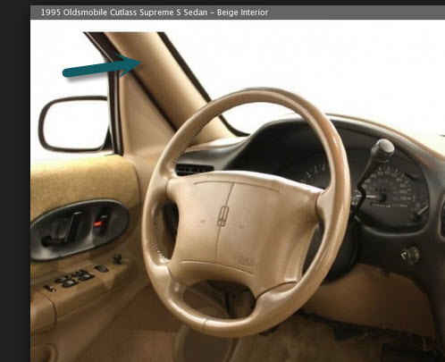

press57 Posted December 25, 2014 Report Posted December 25, 2014 Hello, I own a 95 Cutlass Supreme convertible in excellent shape but I do want to replace one interior part but I have no idea what it is called. Please see the image I copied below. The arrow indicates the part I want to replaced. What is it called and/or the part number? I've tried interior post, post cover, column, column cover but no luck. On in my car (black interior) in its center, it has puckered causing about a 2 inch bump... Any info is appreciated. Thanks everyone Quote
RobertISaar Posted December 25, 2014 Report Posted December 25, 2014 I would refer to that as the A-pillar trim/cover. Quote
19Cutlass94 Posted December 25, 2014 Report Posted December 25, 2014 ya A-pillar, should just pop off. Probably with some effort though. Depending on how good those clips are holding it on. Quote
press57 Posted December 25, 2014 Author Report Posted December 25, 2014 Thanks Jay and Robert, with your help I've found the part number, etc. I've checked my usual spots and nothing used right now posted but similar used parts are going for about $20. I did find new ones, they go for around $65 but they are paint to match so my next questions is, if I end up buying a paint to match part, where can I find the color codes for my interior trim/dash listed and a good place to then buy the paint? I've never attempted painting interior trim before but am assuming it'd be pretty simple or am I wrong? thanks again guys.... Quote
Nas Escobar Posted December 25, 2014 Report Posted December 25, 2014 Anything that involves paint involves sanding, priming and laying down numerous coats. I personally would wrap the trim pieces if I was you. That's what I did to those trim pieces. Quote
Heartbeat1991 Posted December 26, 2014 Report Posted December 26, 2014 I would just find a used one in the right color. Quote
press57 Posted December 27, 2014 Author Report Posted December 27, 2014 I followed Jay's instructions and he was right, I was able to pop the trim right off. Nas was right (everyone is right on here) as it's not painted, it's covered. Shows how much I know. All that said, it's not in as bad of shape as I thought. I think with a little heat I can straighten it out without any issue, problem solved. Thanks again everyone.... Quote
Nas Escobar Posted December 27, 2014 Report Posted December 27, 2014 Not a problem. If you find the vinyl can't be reformed to its original form then you can get vinyl at a fabric store. They're not hard to wrap. Quote
press57 Posted January 4, 2015 Author Report Posted January 4, 2015 An update, used a heat gun and reshaped the bad spot on the pillar trim, let it set overnight, then popped it back on the car today. Repair done, looks 100% better. Now I just have to wait for spring. Quote
