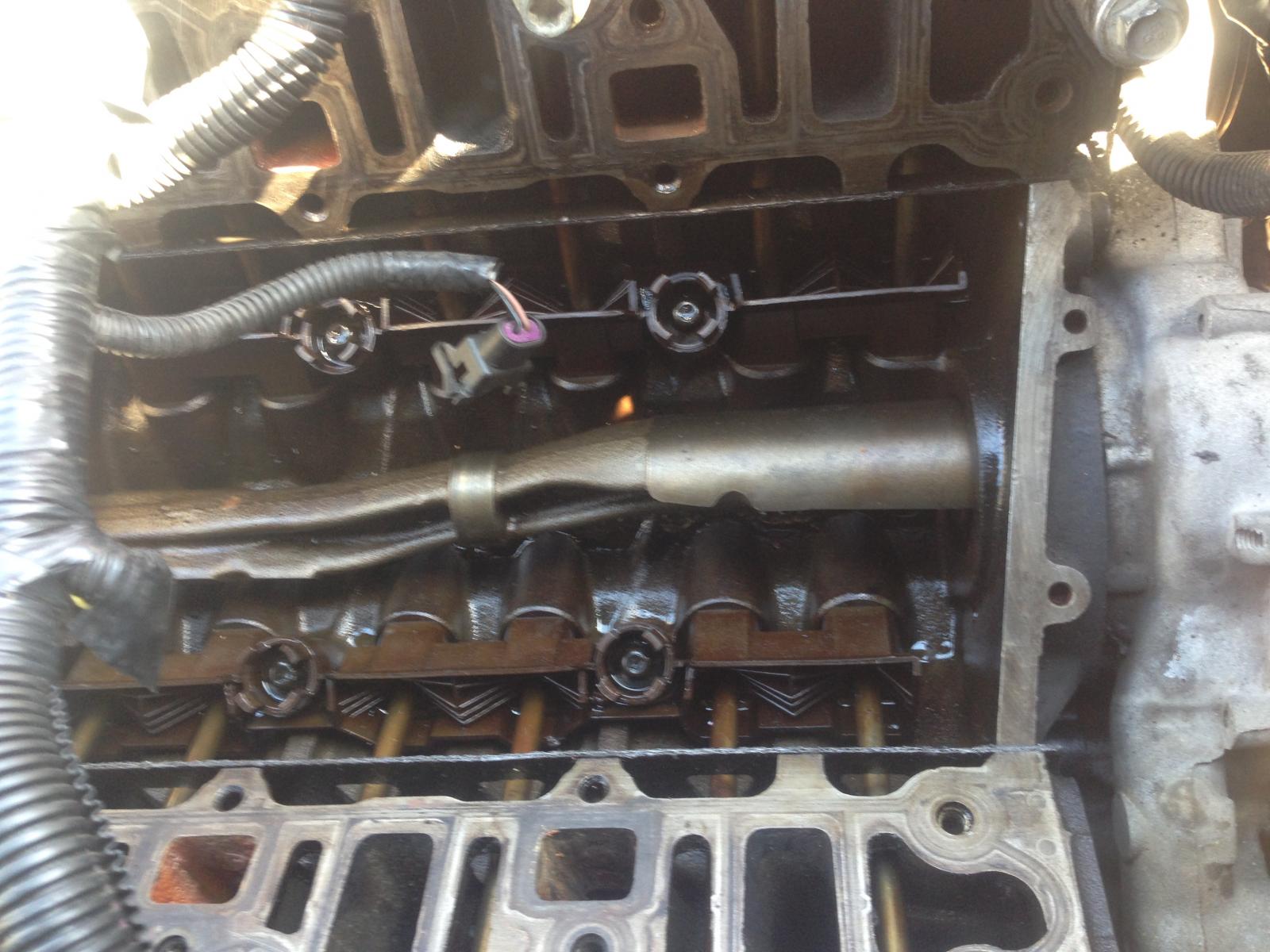

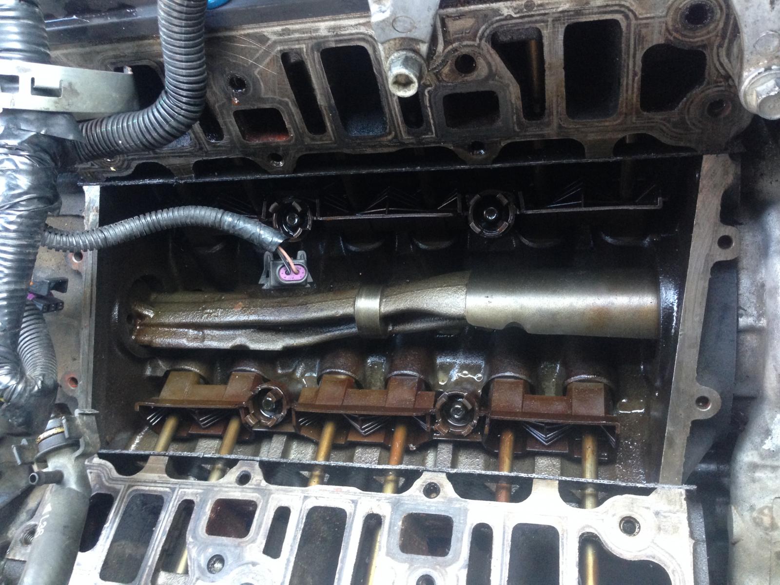

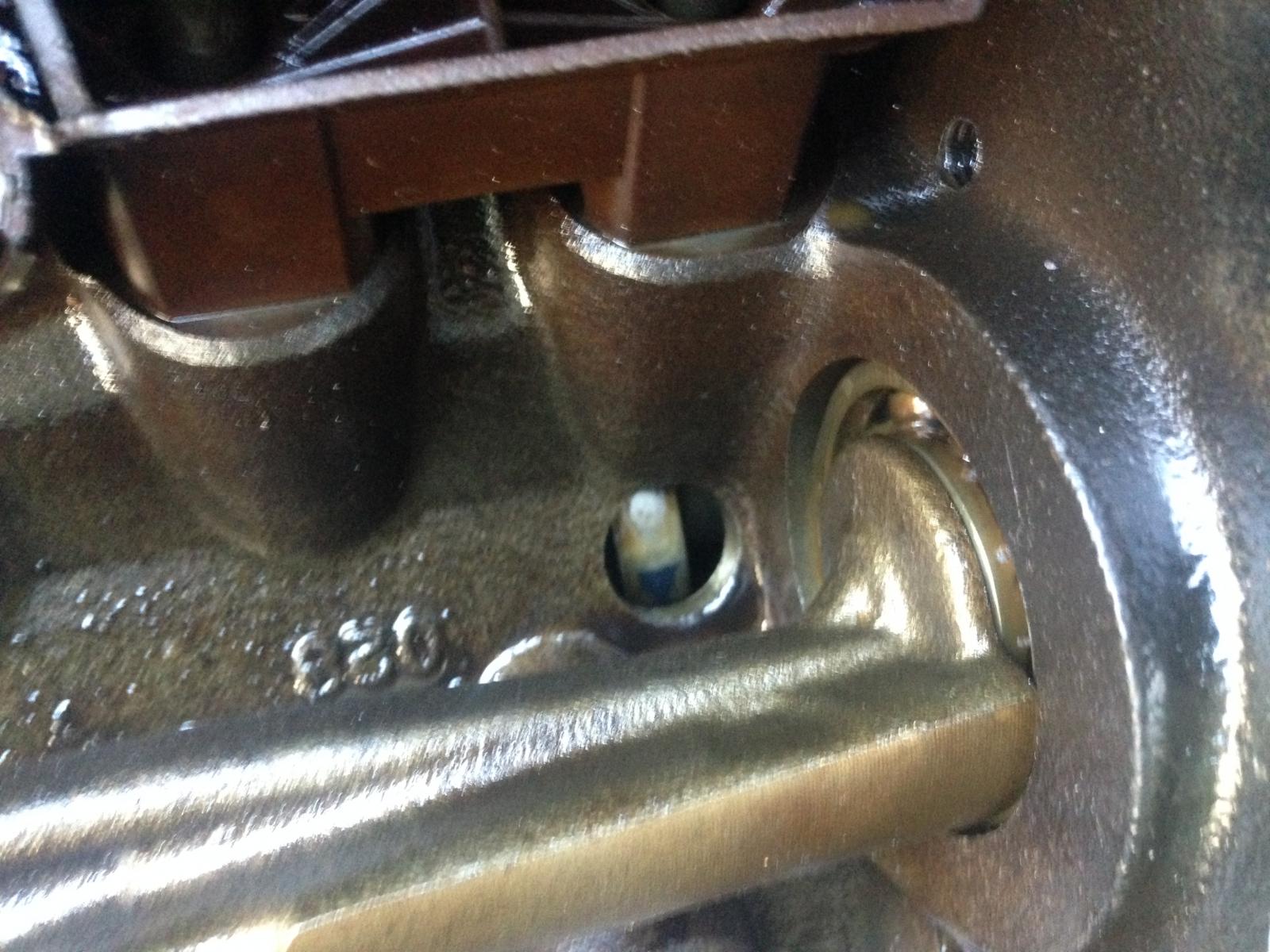

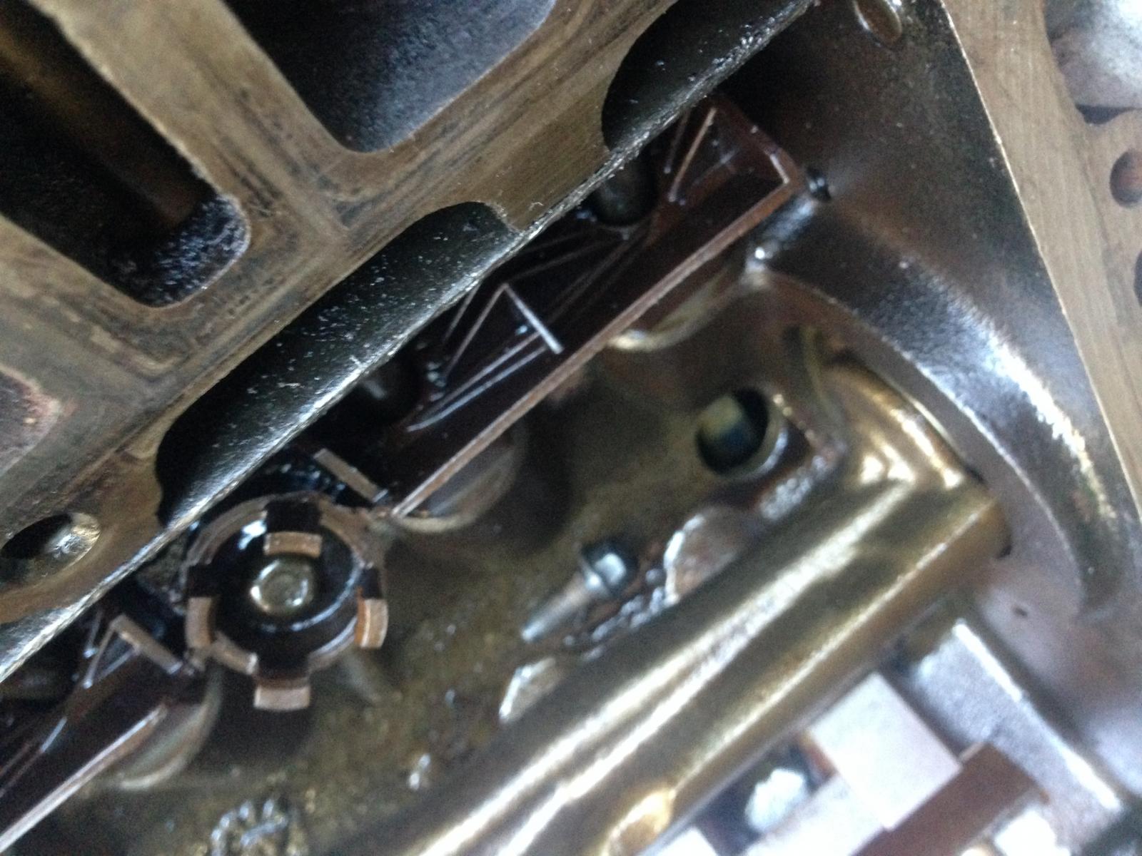

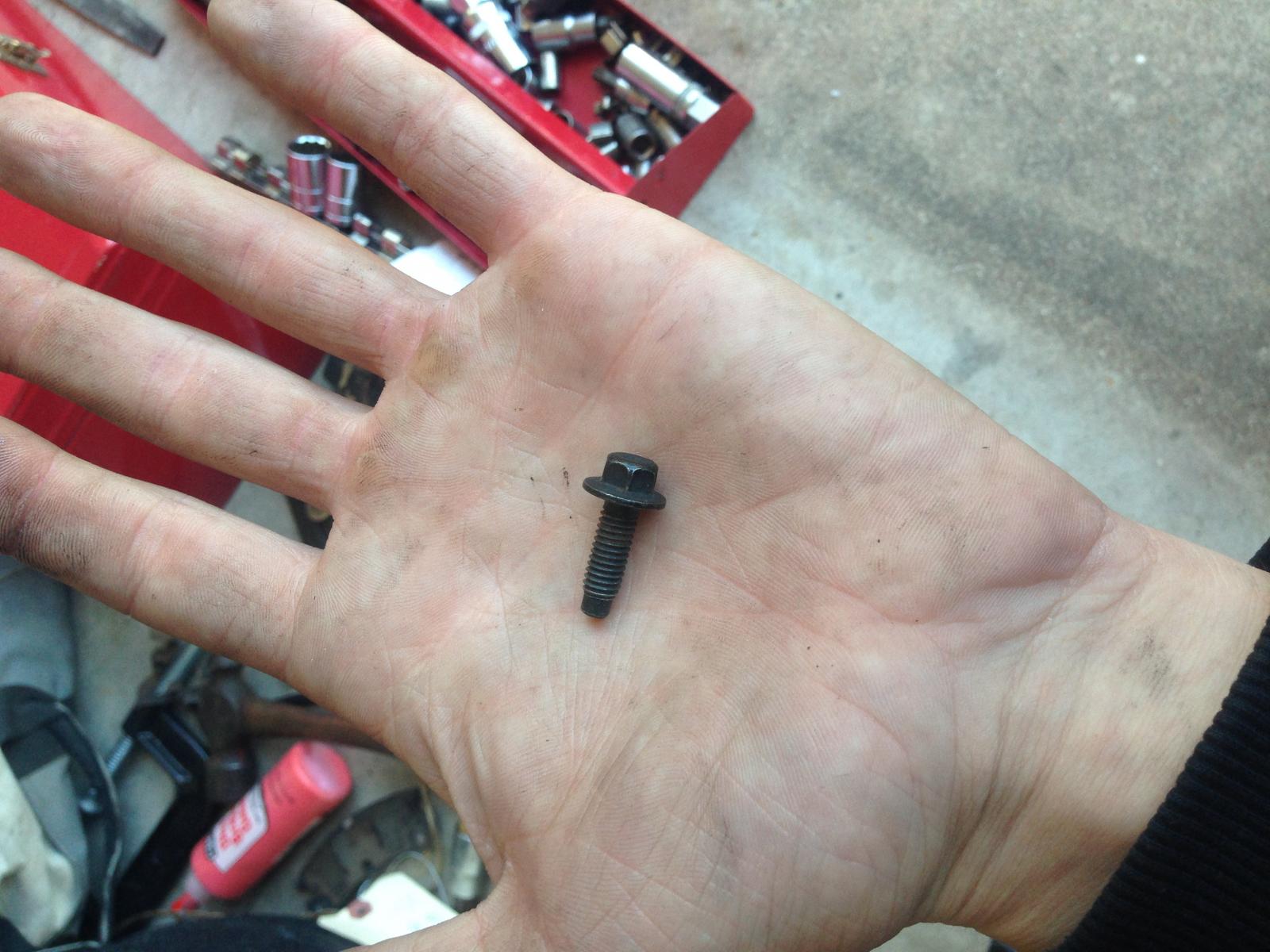

The Gut Posted December 16, 2014 Author Report Posted December 16, 2014 heres pictures of the hole, the screw, and the 2 side by side Quote
The Gut Posted December 16, 2014 Author Report Posted December 16, 2014 heres pictures of the hole, the screw, and the 2 side by side. ignore the attachments, cant figure out how to get rid of them...[ATTACH=CONFIG]18110[/ATTACH][ATTACH=CONFIG]18111[/ATTACH][ATTACH=CONFIG]18112[/ATTACH] Quote
