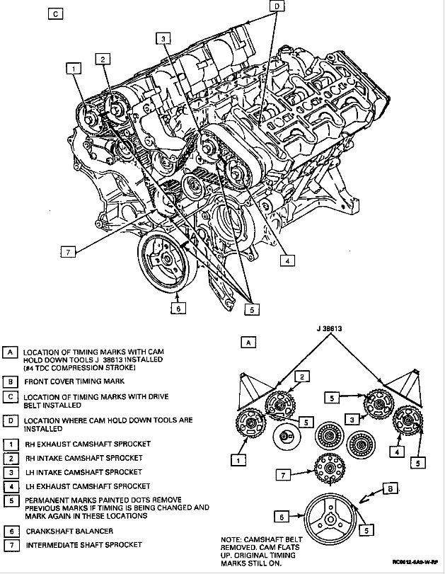

Arkin Posted December 25, 2014 Author Report Posted December 25, 2014 hello again ok I've forgotten bout swapping. Better fix the lq1 masterpiece I'm waiting for some parts, the main issue for now is set the correct timing. Seems like that was the only problem for previous owners I got AllData, it tells I need special tools to do that. 75$ averaged price for it, anyway I can't get it So I need info on how to adjust timing without it. Got some diagrams here. What else do I have to know? The piston upper dead points, right? What is the function of those triangular brackets called "special tool"? thanx Quote
jman093 Posted December 25, 2014 Report Posted December 25, 2014 The special tool locks the cams down in the proper position with cylinder 1 at top dead center (crankshaft timing mark lined up). Here is one on ebay with Ukraine listed for shipping: http://www.ebay.com/itm/KENT-MOORE-J-38613-CAMSHAFT-TIMING-CLAMPS-TOOL-SET-66-/251737403631?hash=item3a9cb7f0ef&item=251737403631&pt=Motors_Automotive_Tools&vxp=mtr#shpCntId Both banks are not done at the same time. Tighten one bank's camshafts, remove the tool for that bank, rotate the engine 180 degrees back to TDC, and then tighten the cams on the other bank. Tightening both banks at the same time without rotating the engine 180 degrees will cause a best a 3 cylinder misfire, and at worst destroy the engine. Quote
tsilney Posted December 25, 2014 Report Posted December 25, 2014 http://60degreev6.com/forum/showthread.php?t=50684 I used this link and made my own hold downs. Piece of bar stock and a bolt. Quote
