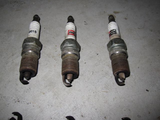

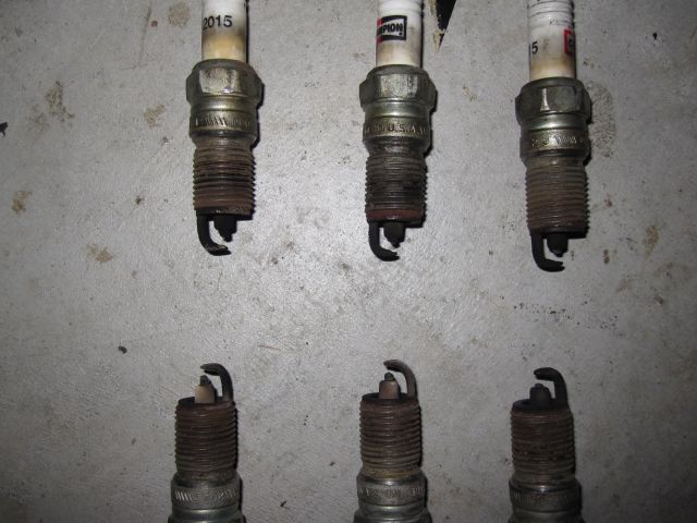

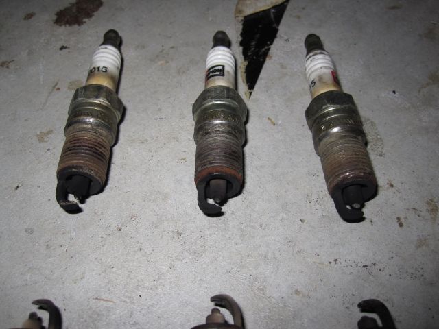

GnatGoSplat Posted December 14, 2014 Author Report Posted December 14, 2014 Pulled the plugs. Looks like those who thought I should replace all the injectors were right. Yes, yes, you told me so. The stock GM injectors run significantly leaner than the Standard replacements and the car runs rich enough to have triggered a trouble code 45. Total waste of $100 ($90+gaskets and O-rings). Lift toilet lid, insert $100, and flush. Overview of the plugs. Top row is 1 3 5, bottom row 2 4 6. 1=Standard FJ105T 3=Standard FJ105 (1997) 5=Standard FJ105T 2=Original GM 4=Original GM 6=Standard FJ105 (new) Closer view showing 6 4 2. 2, 4 = Original GM, looking like they run much leaner than the rest. 6 = Standard FJ105 (new) mostly all black, running richer than the GMs by far. Closer view of 1 3 5. 1, 5=new Standard FJ105T. These look to be running richest of all, no hint of insulator color shows even with camera flash. 3 = Standard FJ105 from 1997. Running richer than the original GM, looks close to the other new FJ105 (but different nozzle design, old one has single nozzle jet while new FJ105 has triple jet design similar to FJ105T). Looks pretty well matched to the other FJ105 in pics, though when I eyeballed it I thought the newer one looked slightly richer than the old one. Probably didn't notice any idle roughness the past 17yrs because 1 slightly rich injector probably doesn't make that much difference. Lesson learned: Mixing brands and models of injectors is very likely to end up very unbalanced. Best to replace as a set, unless you replace with the exact same brand and model, then that would probably be okay. Even FJ105 vs FJ105T doesn't look like a good mix as the newer FJ105Ts appear to run slightly richer than the FJ105s to my eyes. I don't care about the rough idle so much as I don't want to risk killing the cat with a rich mixture so I'll probably drop $170 on a full set of FJ105Ts from eBay unless someone has a better idea. Quote
