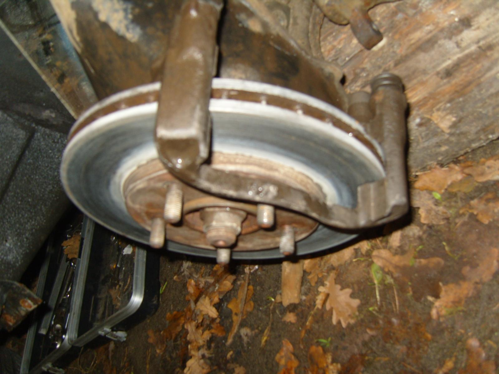

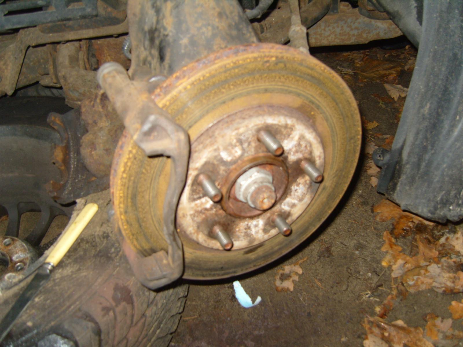

Dinsdale Posted November 22, 2014 Author Report Posted November 22, 2014 (edited) pitzel said: What exactly are you 'cleaning'? Are the passages plugged with dirt or something? The rotors were recently machined, and the brown you saw on the pad area is just very light coloring caused by the damp air we have here at the moment. The guy who did the machining did just that, with no further cleaning. The passages weren't blocked but there was quite a lot of what I call shale (thin, flaky stone in British English)......bits of rust lightly attached to the metal, which is easy to displace with a scratcher. There was dirt too, and visually a lack of definition to the insides of the rotors. All this stuff would remain damp after wet weather, instead of the rotors quickly drying out, thus accelerating rusting. It didn't take long to do and I reckon it was time well spent. The rotors certainly look better on close inspection - like mechanical parts, and not pieces of junk . I did the video after the cleaning, so the owner could see what I was doing with her car. In the video, then, you only get the clean view. It was pretty grim looking earlier. Here's a pic of a cleaned-up front rotor. Both front rotors are still on the car because I don't have the big Torx tool to remove the bracket: In the next pic you can see all the "shale", with an orange appearance....also varying shades of brown: With brakes, I go all the way and don't watch the clock. If I see something I don't like, I deal with it. I reckon it saves money in the long run. The goal here is to get everything as clean as possible, so when it comes back after the winter it'll be a pleasant job to simply spruce stuff up a bit back to the state it's all in now. I wrote earlier somewhere that all four of these caliper assemblies looked tragic. Under all the crap and shale, they are surprisingly in excellent condition, and I have nothing further to do except for cleaning out the old slider grease and smearing new on. I'm doing this because I don't know what kind of grease is in there, so just playing safe with the correct type for the job. Edited November 22, 2014 by Dinsdale Quote
