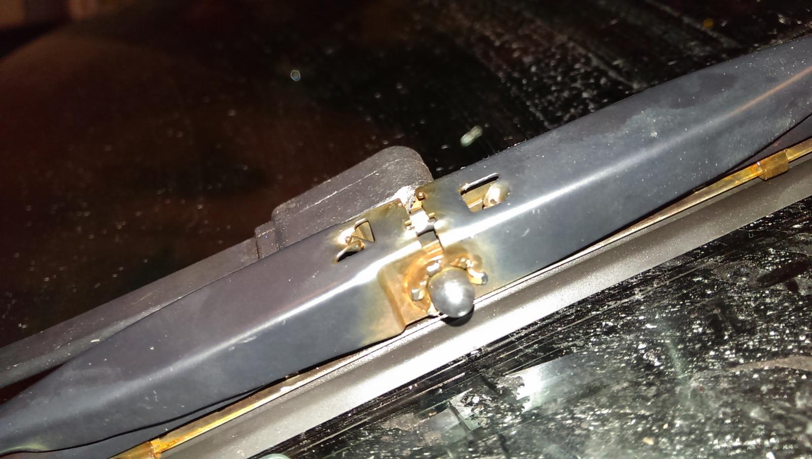

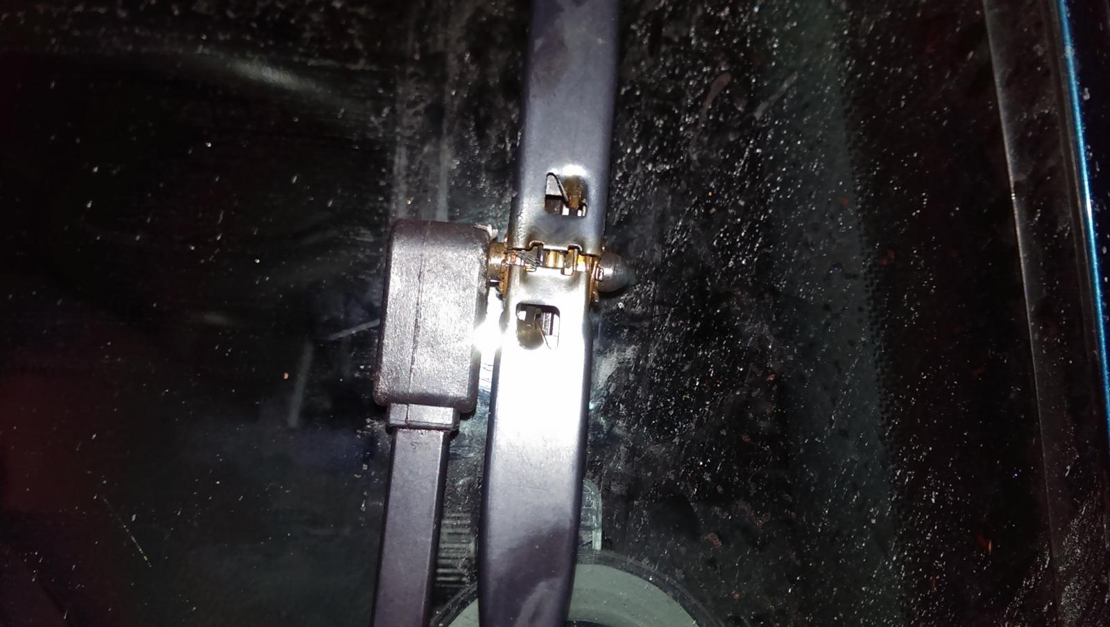

will_s95 Posted November 18, 2014 Report Posted November 18, 2014 I cannot figure out for the life of me how to get the wiper blades off of my car! I purchased new Rainx ones to replace the ones I have now that don't work well, but I cant get the darn things off! looks like there is some kind of lock or something on both sides of the blade hinge? Idk! The car is a 1995 Grand Prix. Quote

George Posted November 22, 2014 Report Posted November 22, 2014 There is wound retention spring inside that type. Hold the arm with one hand, rotate the blade with the other while pulling as hard as you can. There does look to be some rust in there, might spay some PB Blaster or other penetrating oil in there as well. Maybe try pushing the stud through the wiper with a channel locks or a vise grips. The new ones may slide on the stud with a clip to lock it in place like mentioned above. Let us know what works. Quote
