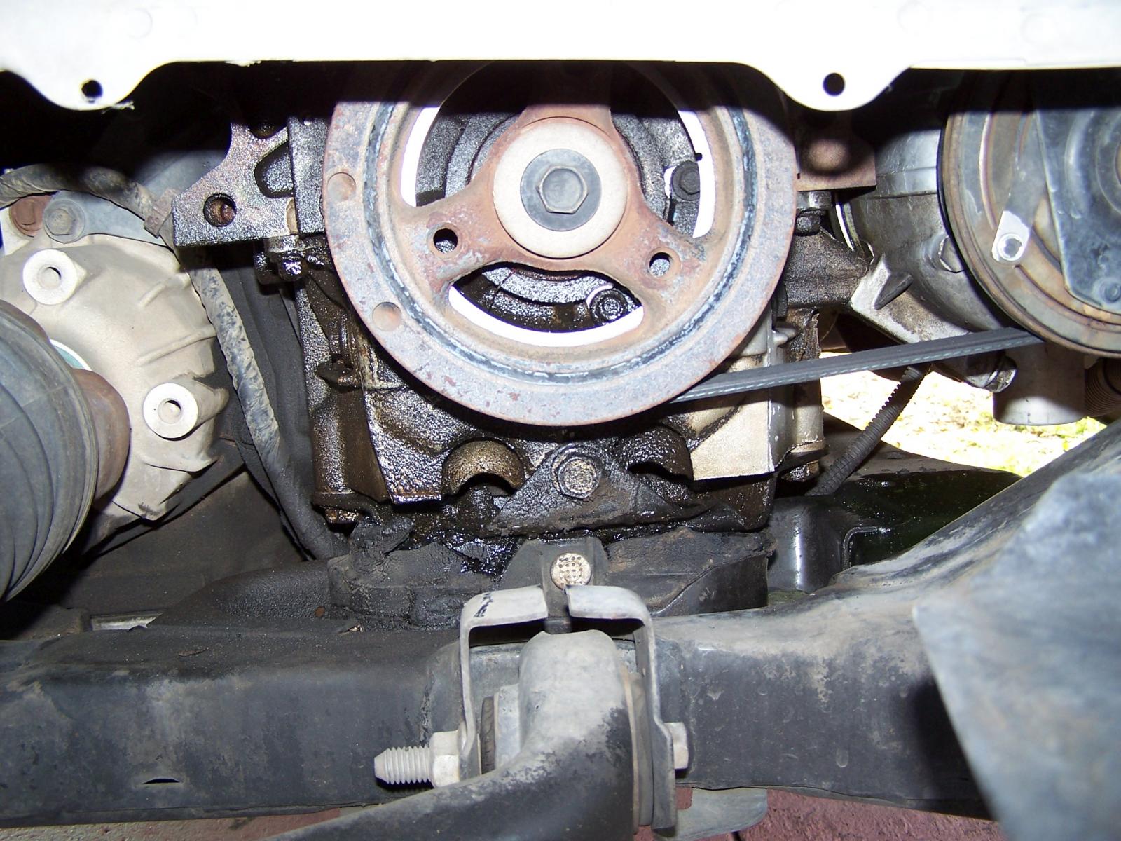

World's Greatest Engine Mount.....RIGHT!!!!
Looks like its time again for a lower engine mount GRRR!:think:
well at least i wont get all stickey .... oh HELLL GRRRRR I FORGOTS:lol:
lol i knew i had a bad mount just funnin'
cause i grabed one off flebay real discount.
but this time i get to swap that gooey fucker out myself:D:D:D
Do you need this vehicle urgently or can you afford to park it for about a week? If you can park it, get a fluid filled mount drill two holes on opposite ends and drain that crap out. Get your hands on a tube of Liquid Nails or preferred construction adhesive and a caulk gun and fill that F&^%er up until it pushes out the opposite hole. Let it or both lower mounts sit in the sun for about a week, will be better than solid rubber ones.
